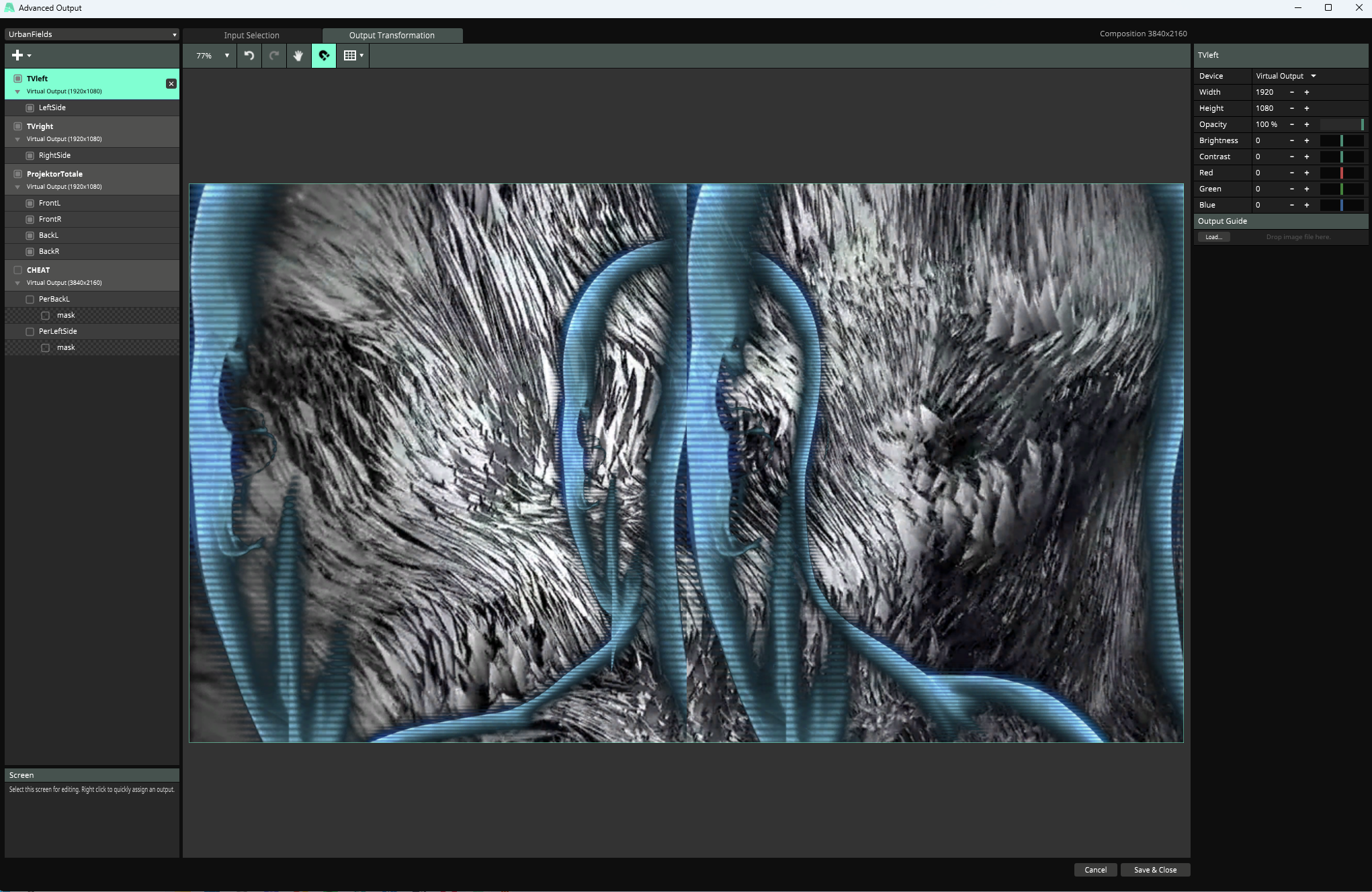

I have a show coming up with the following setup:
2 TVs (full HD) as "main" in front of the DJ
and
1 Projector (full HD) with 4 mapped slices, two on each side.
(The TVs could do 4k but I don't really want to make the composition bigger because I don't know how my 4070 will handle that
, also my content is full HD at best...)
I have a 4k composition setup so i can fit both TVs side by side, centered in height.
And overlapping those I have the whole 4k divided into 4 columns.
My problem is the same as the original posters: I want to use the slice transform for logos etc. but get artifacts on all slices since they sample the same area.
I tried with the cheat slices but didn't get it to work so that I can address them separately. Wouldn't my masks of the slices be the same size as the slice rendering it useless?
My goal is to have a logo layer as well as different looks:
The TVs as a single wide image or as 2 separate images sampling the whole 4k (but mirrored and rotations to the middle)
And the mapped rectangles the same with one look as a single image sampling the whole 4k and also the 4 rectangles as their own screen.
If that's achievable.. how do I do it?
Maybe there is more informational content out there I could watch/read?
Thanks in advance,
Paul
