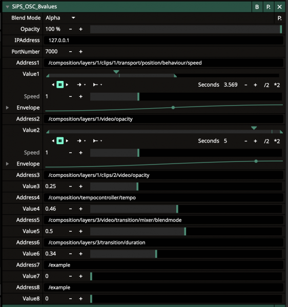

The only way to do that without routing to external software would be to create FFGL plugins. That cannot be implemented (currently) in Wire. Joris has made one for Windows, and I have made one for Mac that can control 8 custom OSCs. Both work well.
