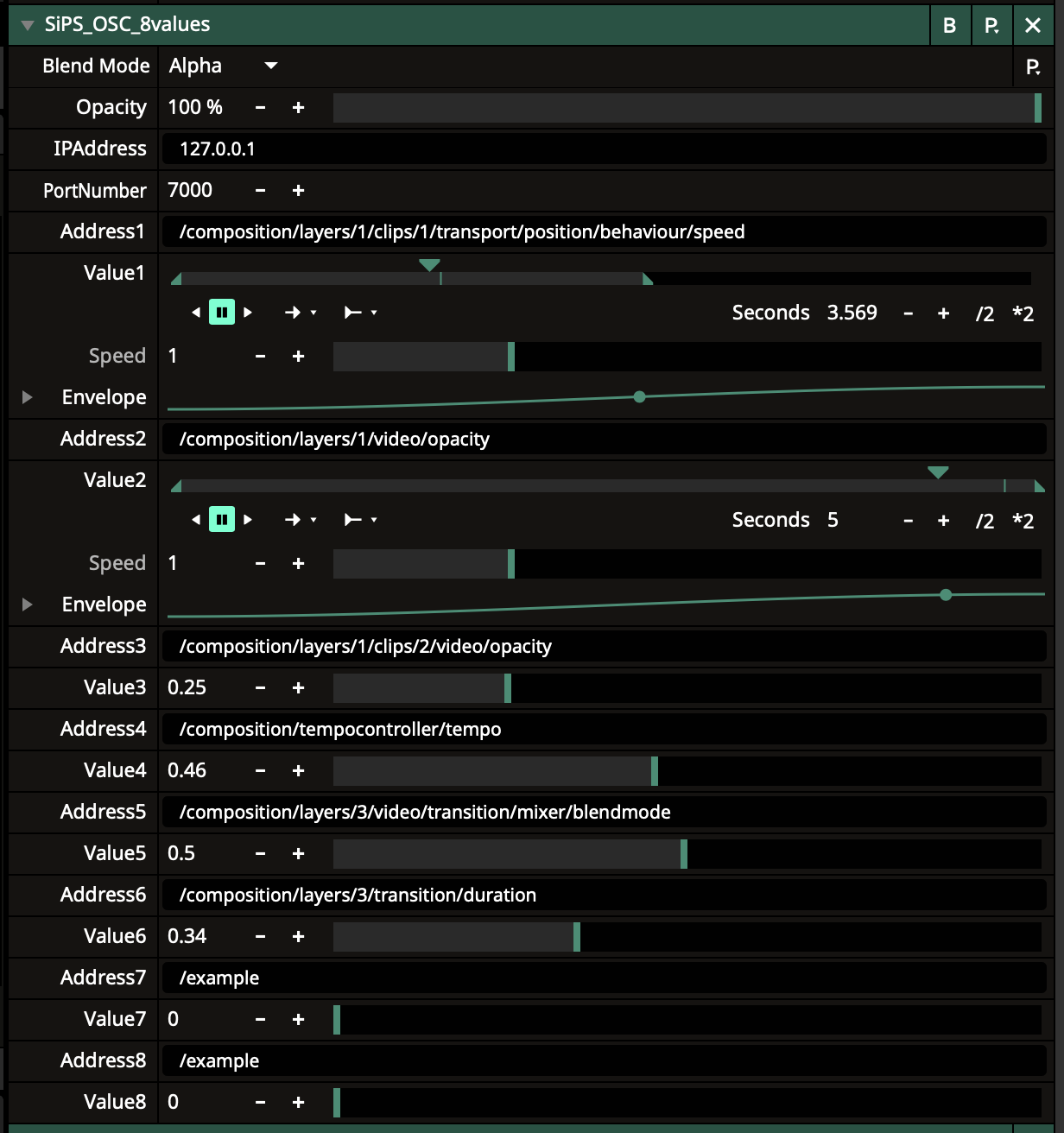

The only way to do that without routing to external software would be to create FFGL plugins. That cannot be implemented (currently) in Wire. Joris has made one for Windows, and I have made one for Mac that can control 8 custom OSCs. Both work well.

sipsipsips
Posts: 8
Joined: Mon Sep 16, 2019 15:44
Location: Tokyo/Japan
Re: OSC Into Wire -> Adjust Values -> OSC Out to Arena
Post by sipsipsips »
Yes, I hope someday Global Shortcut will be built in as a standard feature. I use it myself and find it very useful.
youtube.com/@selfimageprodukts
