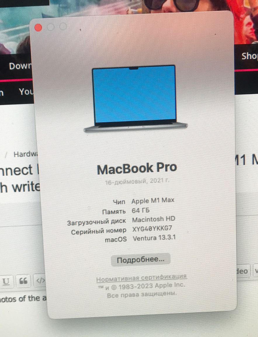

Can't output 4k ( 3840x2160p@30hz ) resolution via Datapath X4.
Laptop MacBook Pro M1 Max 64gb.
The laptop shows that the second screen appeared with 4k resolution, and the Datapath X4 writes No Signal. I can not solve this problem and there is no solution on the forums. I ask for help who can help.

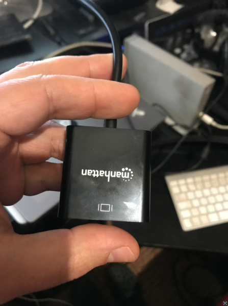

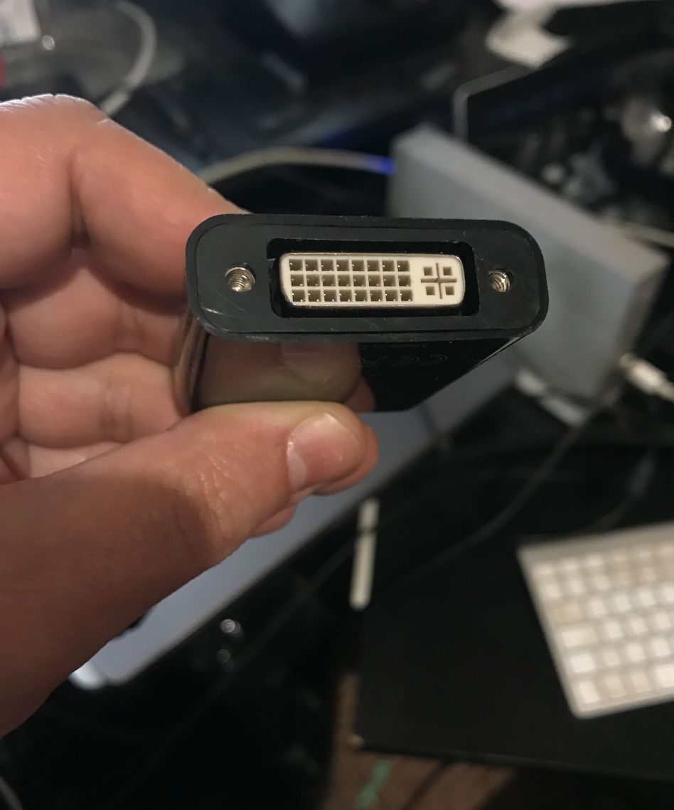

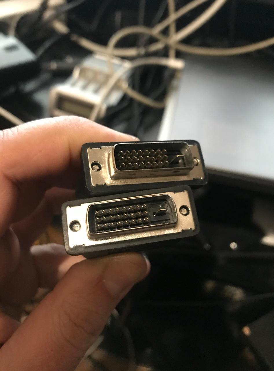

The MacBook Pro M1 Max only has an HDMI output. So I bought a Type C to DVI adapter. The box says that this adapter supports 3820x2160 (4k)
Judging from the analysis, it is Dual DVI.

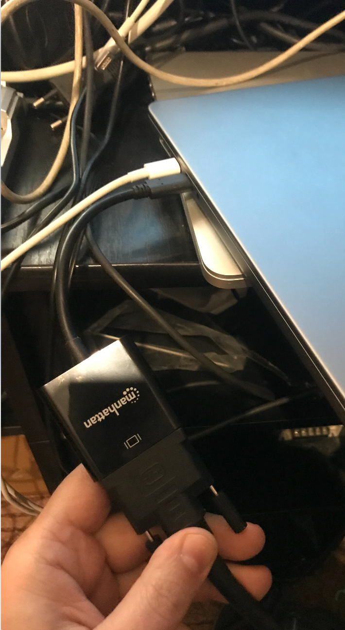

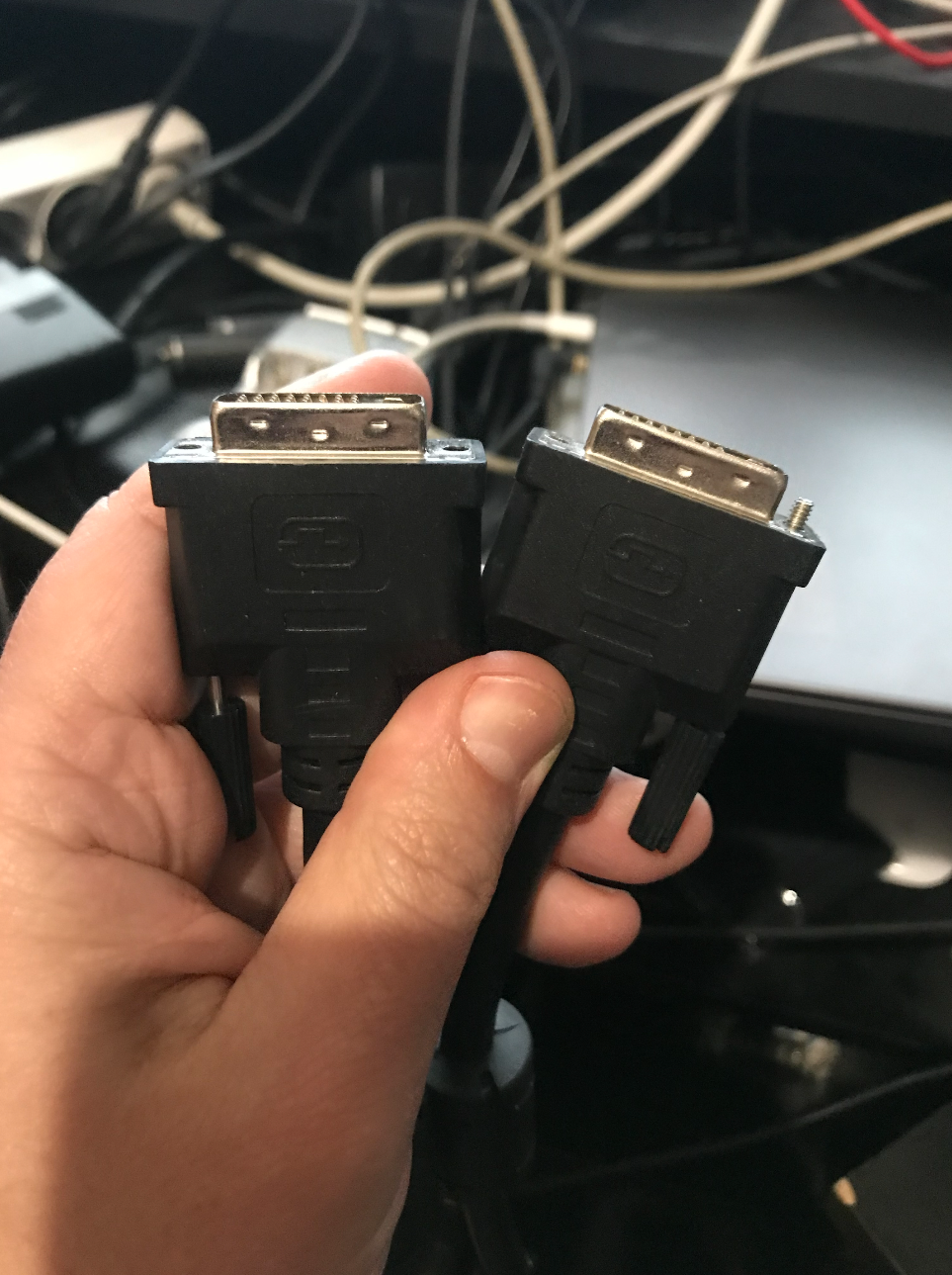

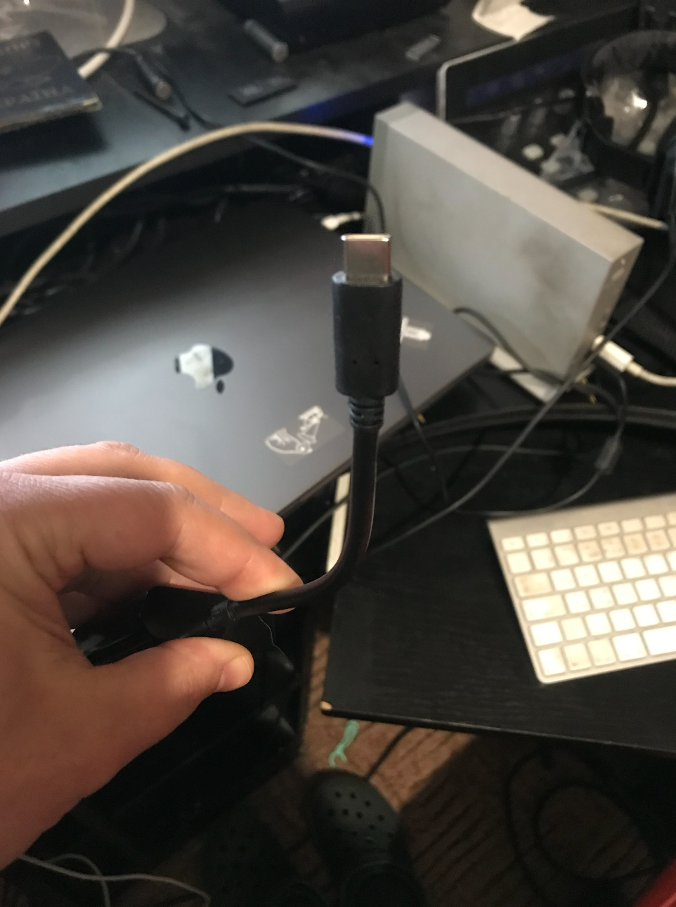

I send photos of the adapter, the settings are on the Datapath X4.

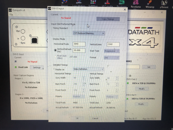

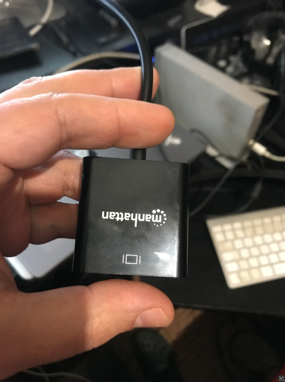

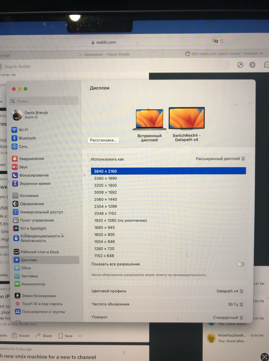

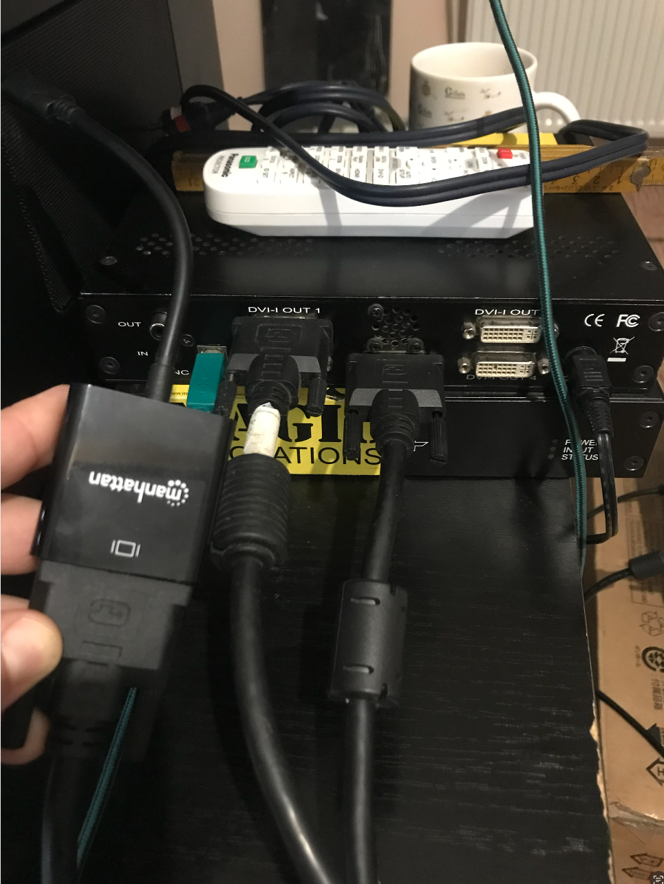

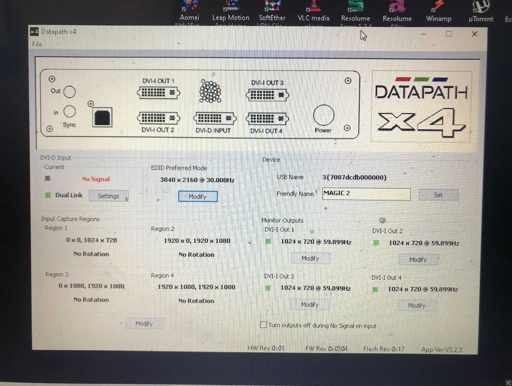

MacBook M1 max shows that there is a 4k screen, but Datapath X4 says no signal.

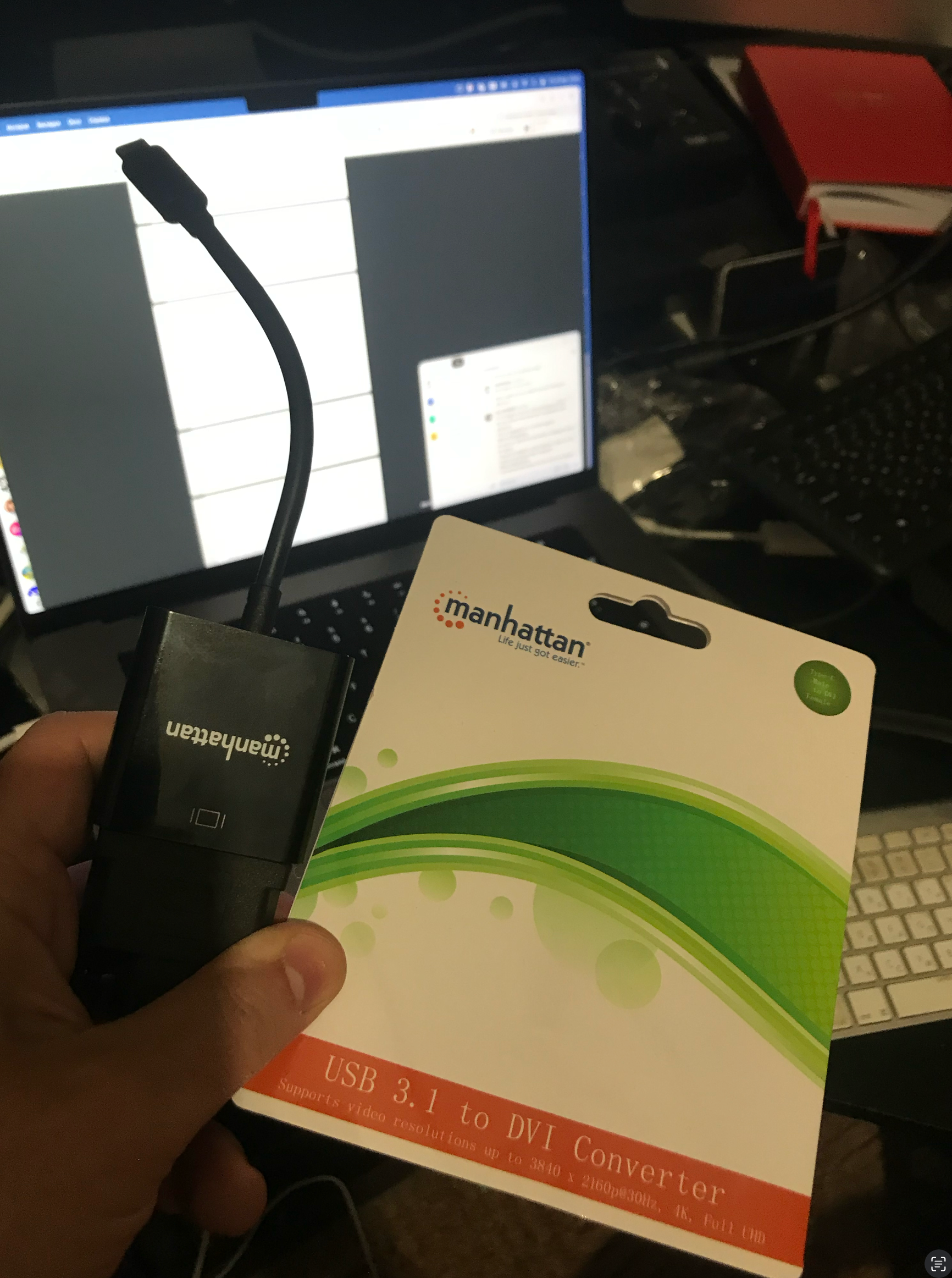

I showed photos of the adapter.
Please tell me what is my mistake.
Why does Datapath write no signal.

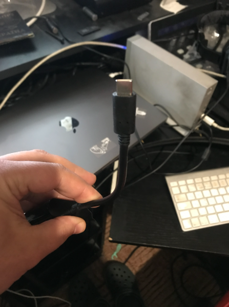

Unfortunately I don't have a Datapath, just a Macbook. One possible problem - the DVI cable should be also able to handle 4k. And another thought - maybe you could try to use a 4K HDMI cable and an adapter to DVI? Just an idea. It works fine for me, but I don't know, if your Datapath would love it too...
