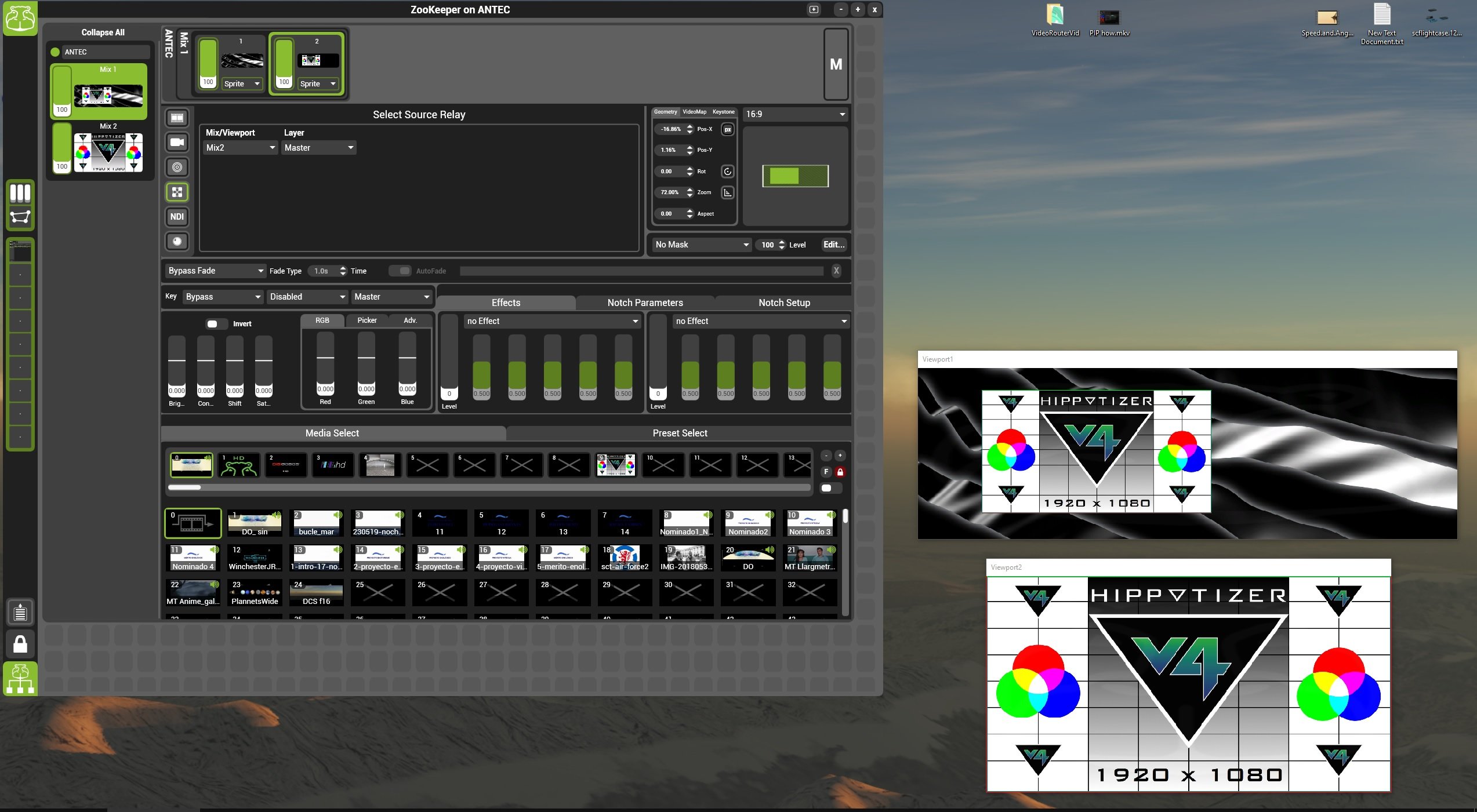

I've watch that entire stream and trying out a few of the things talked about.
Nope, at no point is any of that a solution to what I am trying to solve, which is having a slice, properly centered and cropped, be able to be used as a source on a layer.
At all stages the sampling of the slice takes into account the entire composition for scale and position.
So TLDR, looks like resolume is just not capable of doing this job.
Simple task, take a slice or screen OUTPUT and feed it back in as if it were a clip, properly scaled etc just like any other image or video content.
With a hippo, just take the layer, switch media player to relay, select the source from any layer or mix (group/slice), set geometry as you wish (auto fill, 1:1 pixel etc etc) and that's it. You have latency free copy of any part of the config, that you can correctly scale and position, which has the scaling anchored to the center of that signal just like in any other contents that can be faded in or out, positioned etc etc completely independently as part of the programming or show.
The thing is, if resolume also had an internal true timecode/sync of playback heads, I'd be able to cheat this by playing the video twice and just internally locking the playheads... but also not an option. I'd just have to fade in and out the slave video when I want it.

tijnisfijn wrote: Tue Nov 14, 2023 02:06 OK now I'm getting what you want to do and what the problem was.... See your point... It would nice if the video router could route slices, screens and/or outputs as well.... But I think i found a workaround for you though. Hope this is a solution for you, maybe.... ;)
Yep already tried this!
This is exactly the end result I am looking for and have tried with Spout and NDI.
NDI has inherent latency built into it so not a perfect solution.
Spout is zero latency but there is a noticeable stutter to other contents playing when I load and clear the spout clip.
The issue is causing me to doubt my own sanity.
How can I be the only person who wants to take a clip being played and be able to send a direct data stream copy of it into another layer as if it were the original, with all the same standard ways of working than any other clip be it video, image, text clip, ndi source, capture card etc etc etc?
It's so frustrating to be so close to the answer but not able to get it.
I know I'm "misusing" resolume, that it's more of a performance VJ tool not a media server but this is one tool I see as so crazily useful both in terms of configuration as in vj performances that I don't know why it doesn't exist. Same as "play next/specific column" autopilot option and multi-track audio.
