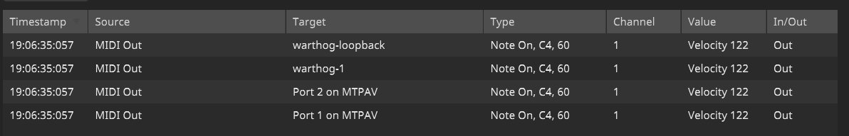

Please add meaningful support for multiport devices that have more than a single MIDI in/out.
For example, my MIDI interface offers 8 ports and looks like this:
Every MIDI event I create in Wire is sent out to all active ports. Here is a single event, button clicked once:
What is needed is an option to specify which port data is being sent out instead of "full broadcast". Ideally, the MIDI out module would offer a dropdown of multiple ports/interfaces data is being sent to. That way, some data could be sent to MIDI receiver A, while other data is sent to receiver B - and all that in the same patch. Or port selection could be added to the different MIDI modules, so we specify "type-data-channel-port" instead of just the first three.
Likewise, from what I see it´s impossible (within patch) to discriminate by incoming MIDI port. Every event on, say, port 1 is seen as "just incoming" not "incoming on port x". That way, Wire operates as an (unwanted) MIDI merger, which is tricky with multiple controllers.
