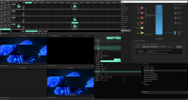

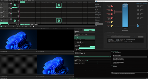

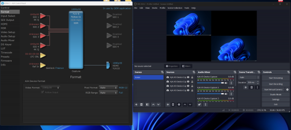

As you can see in the pictures, it is looking great through OBS with all inputs chosen, but only 2 are connected. Everything is working fine.
In resolume it starts glitching when I add input which is not connected. It wouldn't be the problem, but if someone disconnects one input during show all remaining inputs will start to glitch.

You see the glitches on input 1 and 4, only when you load another AJA input SDI3 to the clip grid?
Did you change the genlock from SD1 to free-run manually in AJA control panel in the first shot?
Free-run could explain the glitch you see.
