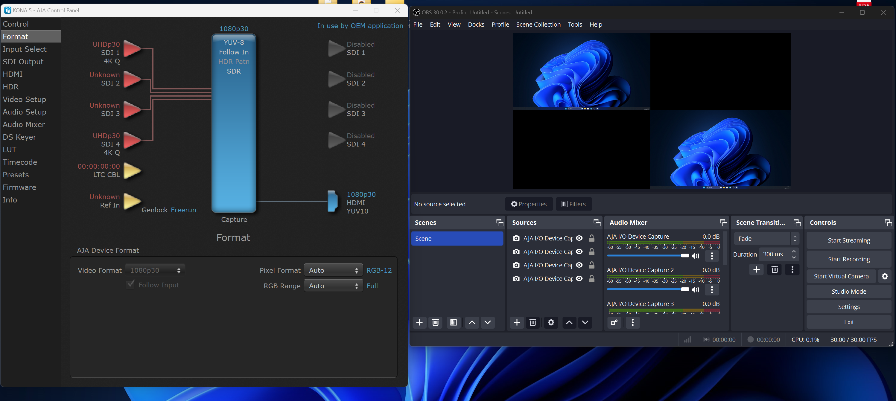

Hi guys.
Having a problem with kinda good KONA 5, but at this point I want to throw it against a wall.
As you can see in the pictures, it is looking great through OBS with all inputs chosen, but only 2 are connected. Everything is working fine.

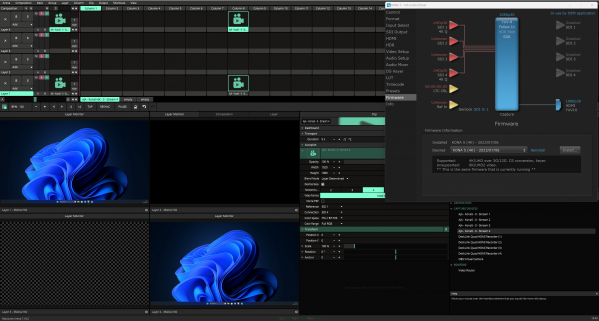

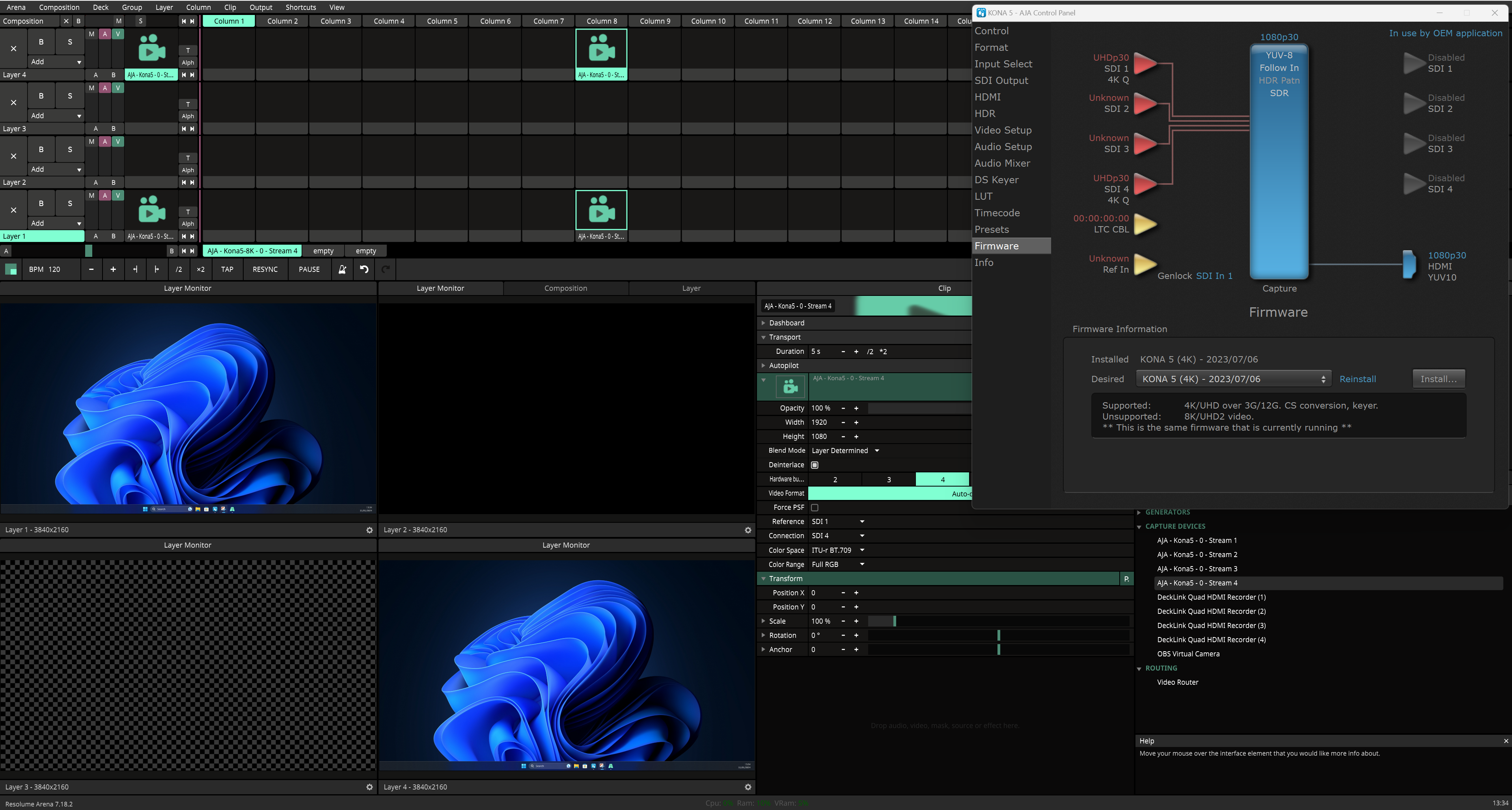

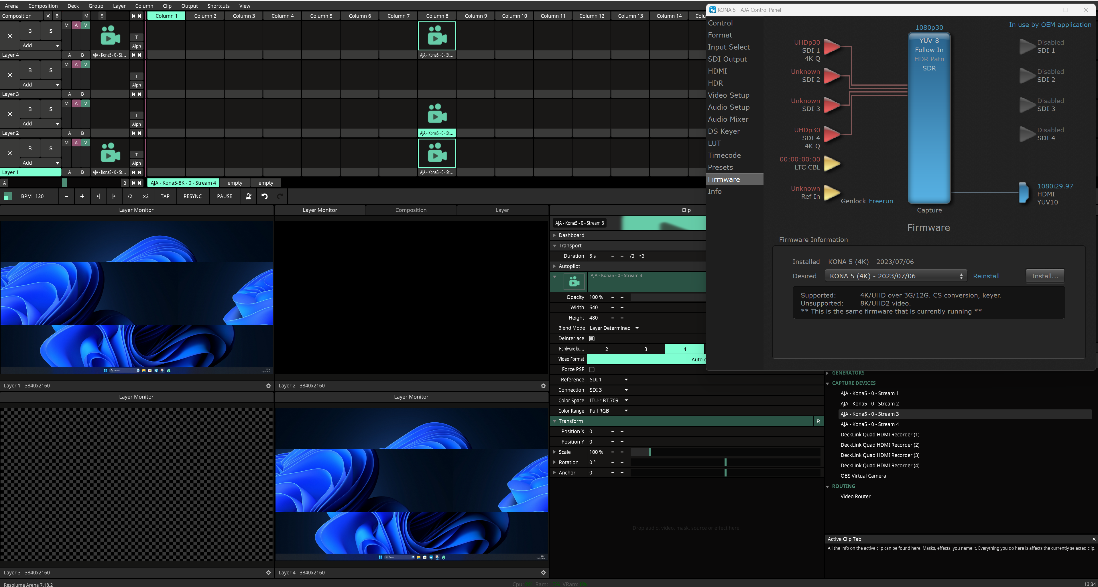

In resolume it starts glitching when I add input which is not connected. It wouldn't be the problem, but if someone disconnects one input during show all remaining inputs will start to glitch.
I think that it has something to do with Directshow filters but not sure.
What are your thoughts.
Posts: 7697
Re: AJA KONA 5
You see the glitches on input 1 and 4, only when you load another AJA input SDI3 to the clip grid?
Did you change the genlock from SD1 to free-run manually in AJA control panel in the first shot?
Free-run could explain the glitch you see.
