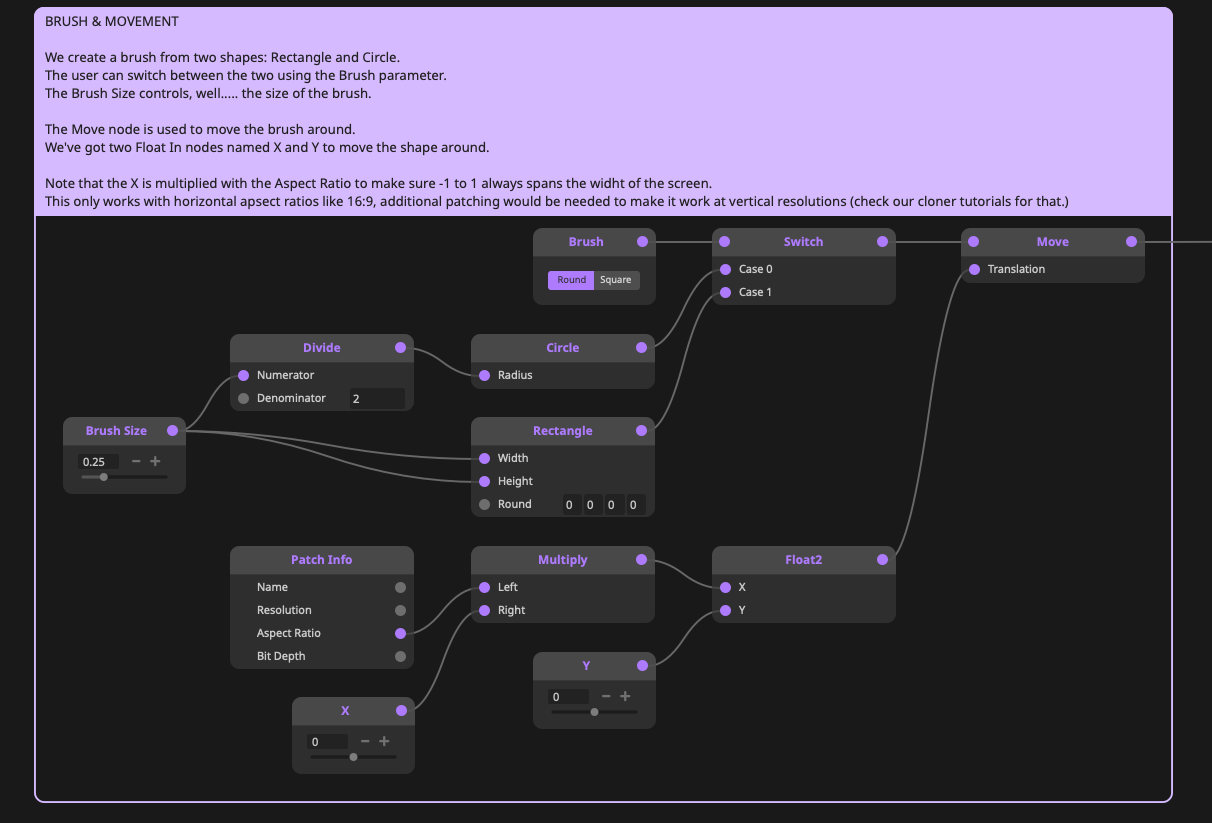

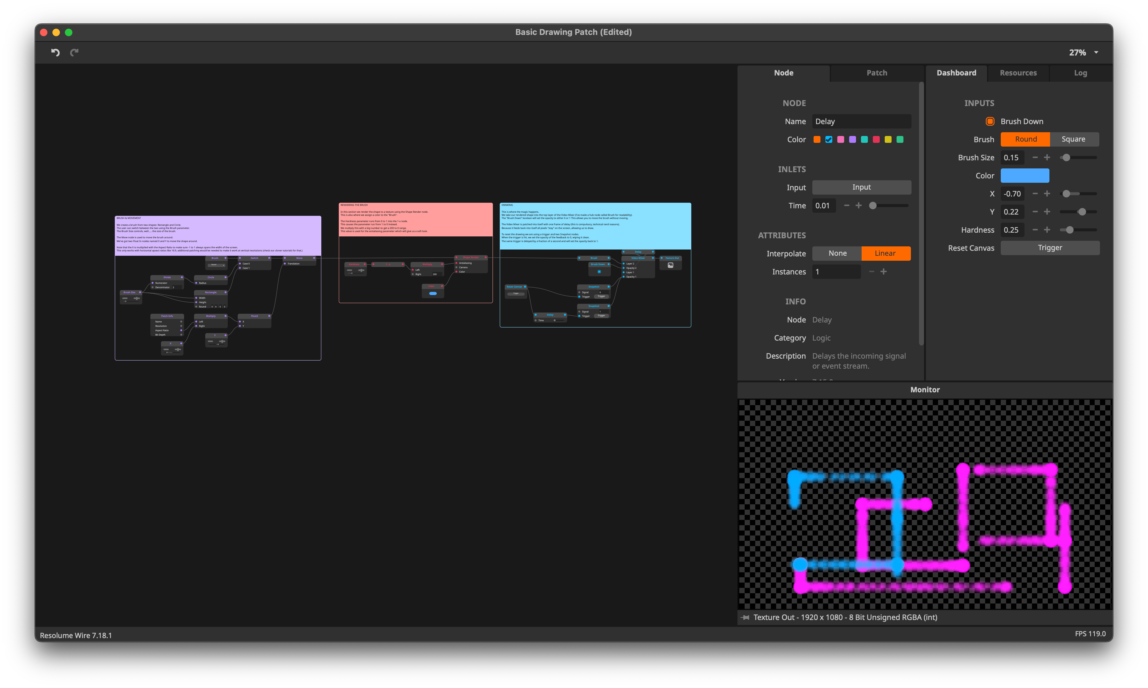

Here are some screenshots of the patch. You might be able to recreate it on your current version.
