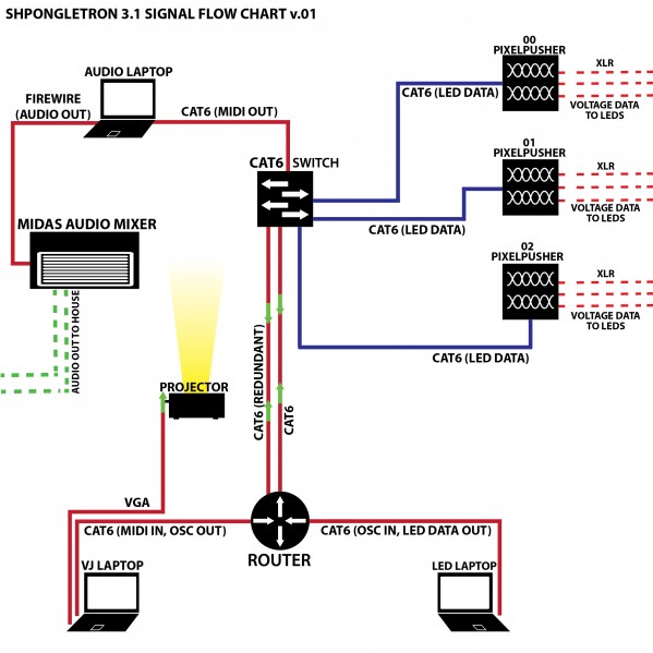

In addition to the excellent help from Ravensc and Oaktown:
To be honest, you have such a crazy interconnected setup going on, it sounds like there is a 'ghost in the machine' somewhere. Resolume doesn't just reset all bpm data in a saved composition, blank out shortcuts or shuts off a clip when it needs to send a cue point. I'm not saying those things aren't happening! But I'm saying it's not what Resolume does out of the box, so something must be causing it to act like that.
If I was to start troubleshooting this, I'd run a lot of tests, each time with a single element not active ( cut out Live, turn on Live again and cut out all the OSC traffic, then send all the OSC except just send cue points via keyboard, then just send clip triggers manually, etc etc ). The moment the undesired behaviour doesn't occur after disabling a certain element, you know what the problem might be.
Either something is adding noise to the signal flow, causing unwanted commands to get activated in Resolume. Or something is really causing Resolume to act weirdly all on its own.
If it's the second case, we need to solve it. During the troubleshooting, you probably narrowed things down to a repeatable set of steps that will make Resolume do the thing it's not supposed to. The moment we know those steps, we can get right on fixing it.
But, again, to be honest, it sounds like it's just a knot of virtual cables that needs to be straightened.

Re: BPM info does not save on restart or clip moving
I think for now I will just keep observing and eliminating options.
Just to be clear though - there shouldn't be any feedback happening from one machine to another - master computer (Arena) is only controlled by the Ableton computer sending it MIDI triggers - so it's not getting any OSC messages, just sending them to slave computer (LED video clips) after those keys are triggered by MIDI from Ableton computer.
Here's a graph of our signal flow by the way, for easy reference: My current whitelist of OSC commands is as follows:

Could any of these be responsible for resetting all of the bpm on the slave computer clips?
The sets on both computers are identical in layer and column numbers, but have clips with different resolutions and titles. My biggest problem is genuinely the inconsistency of it all. As I've mentioned, this crazy gordian knot of a configuration works perfectly well (we preview audio coming out of all 3 computers all at once, and it's perfectly synced up, down to about 10ms or better) 90% of the time. Then, out of the blue, some of those issues I've mentioned might happen; where just the night before - they wouldn't.
I will try to create an OSC dump program on the slave computer, to see if there's anything unwanted sneaking through, but in my understanding - there shouldn't be any OSC message out there that resets all of the BPM counters, is that correct? Just want to figure out where to put a priority marker in my observations.
yes. or at least it could apper to you as a reset or not saving BPM data on the slave:Could any of these be responsible for resetting all of the bpm on the slave computer clips?
if the bpm setting for the clips in the same position should be different like master:/layer1/clip1 bpm is 123 and slave layer1/clip1 bpm is 135
then if you load the master comosition after the slave has been loaded, the master sends out all the info regarding clips and layer settings including the bpm for layer1/clip 1 so in the slave layer1/clip1 bpm will be set to 123.
So you have to be more specific in the whitelist what you would like to allow thru
a simple "bpm" will allow the compositions bpm setting, then each clips bpm setting, then the activeClip bpm - which is the currently selected clip.
the activeClip playhead(playback position) info is sent via osc twice if your clip is actively playing. so a Select /deselect via activeClip osc message will stop the clip playback eventually. (besides causing jerky playback because of the double position information)
I would start with a blank filter, then be very specific about what you want to let thru.
After you have no issues, then you could add more to the whitelist if you are missing functions.
-----start of whitelist --
compostition/
playbackcontroller/ # for bpm, tap, resync etc.
layer1/video/ # this will let thru effect settings too.
layer1/audio/
layer1/opacityandvolume
layer1/transitiontime
- these repeating for every layer you have.
bypassed
solo
clear
connect # this can have int 0 or 1 where 1 is connect and 0 is disconnect.
video/position/jumptopointsofinterest
audio/position/jumptopointsofinterest
----- End of whitelist --
do you really need clip preview in the slaves?
if you are programming in processing then make a blacklist for:
----- start of blacklist --
activeclip
activelayer
preview
video/addsubtractr
video/addsubtractg
video/addsubtractb
----- End of blacklist --
both your vj and led laptop is a mac right?
edit: so basically on composition load and deck switch, all the clips layers and effects information is sent out to the slave to get in sync. All you see in OSC mapping and more!
This is very good if you run a mirror of the master in the slave, but not good for syncing different content and settings.
there is a lot of cleaning up to do in the osc implementaton for master-slave operation
