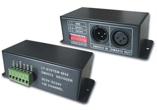

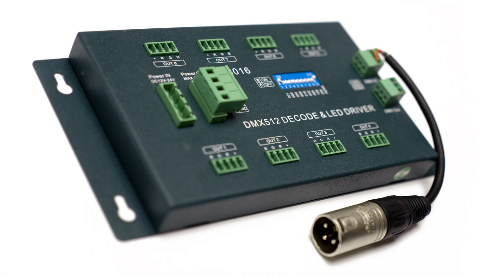

I am new in using resolume and DMX, according to the manual is recommended to use the product of enttec. while in Indonesia there is no enttec sellers.
if I want to control the LED strip from resolume, can I use other than enttec product?
eg Chinese products or something else?

you don't need enttec hardware at all....but neither of what you posted will work with Resolume
one appears to be a dmx to cv converter and the other drives LEDs...
