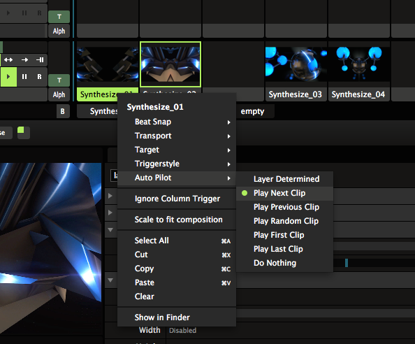

watchout, Resolume, Isadora and Qlab can do this various ways, Resolume would be the trickiest but you could totally do it.
Re: semi-auto timeline with loops?
I'm not 100% sure if I understood you correctly, but I think this is relatively straightforward using a combination of AutoPilot and Layer Transitions.
What I think you want is this: Clip 1 should play to the end, then switch to Clip 2 automatically. Clip 2 should then loop until the user decides. Repeat for 3 and 4, 5 and 6 etc.
To get this behaviour, import Clip 1 and 2 next to each other. Right click on Clip 1, and set the Auto Pilot to Play Next Clip. Right Click on Clip 2 and set the Auto Pilot to Do Nothing. Do Nothing actually means it will loop until you click another clip. At that point it will start playing the clip you chose.
Repeat this process for as many clips as you need.
If you want a transition between the clips, just turn on the Layer Transition for that layer: https://resolume.com/manual/en/r4/layer ... ransitions
Hope that helps!

Great! Baby steps so far, but this is totally working.
