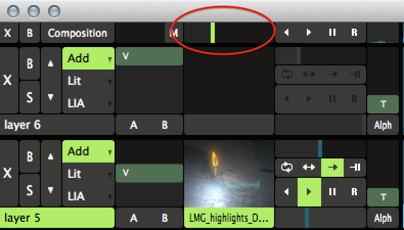

Re: Resolume running in "slow motion"?
Glad you found the solution to your problem but another thing you want to look at when you compositions start going slow for no reason is the composition overall speed.
You can reset the 100% by right clicking on the area.
It happened to me on a show a while back. I bumped it by accident and all my movies started playing slow. Since I didn't know about this slider, I had to go back and adjust the speed of every clip in my deck which was a real pain!

Oaktown thank you for that. I don't know if that was part of the problem (since the buffer thing seemed to correct my issue) but I brought that composition speed slider up and when I drug it slower it did exactly the same issue I was complaining about. Another good thing to check!
