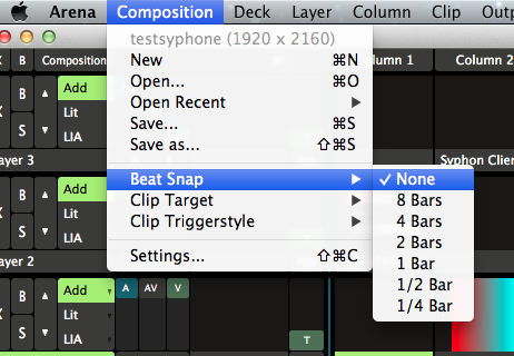

to get instant triggering you must have beat snap set to "none"
Screen Shot 2014-12-19 at 13.31.46.png (71.3 KiB) Viewed 21933 times
