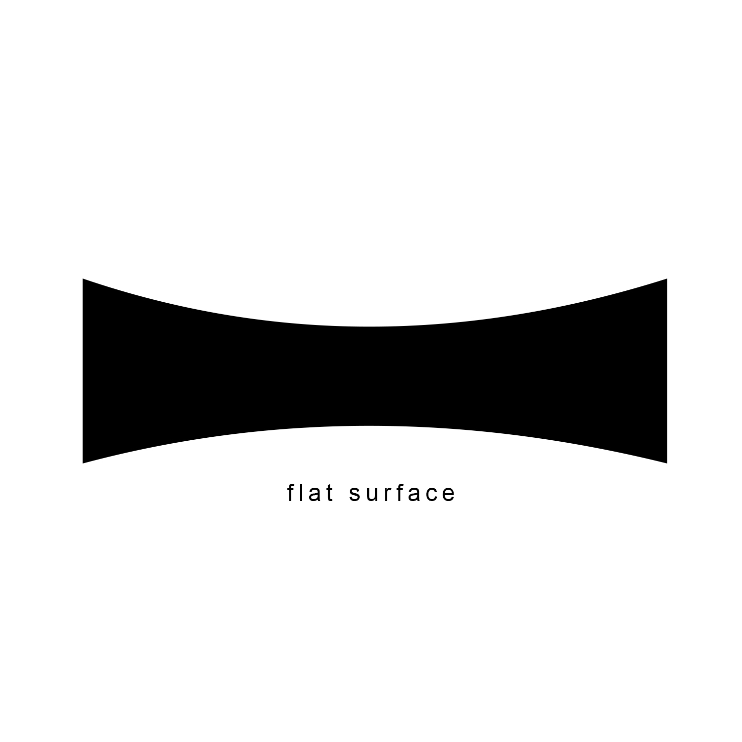

The client is building an arena, with a flat surface, it just has some curves in the edges (see attachment)

Surface
Surface
