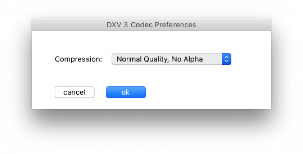

so why cant resolume read my alpha channel in the dxv3 codec?

Make sure you encode your videos in 32-bit, not 24-bit, for alpha. If that still produces no alpha then encode in DXV3 High Quality.
Posts: 7710
Re: Second Mapping with Soft Edge
also the alpha has to be enabled separately int he codec preferences, and you need to have a source with alpha of course.
which program are you using to render?
