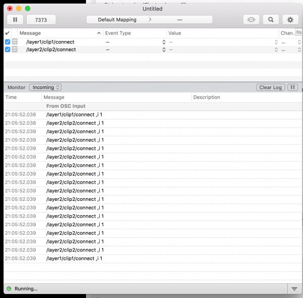

Okay that works - Processing is now sending an OSC Message (checked that with OSCulator).
But still Resolume does not play the desired video. What could be wrong here?

from the timestamps it looks like you are sending the osc messages constantly, I guess that's not what you intend.
It looks like it would make resolume restart the clip 10 times per millisecond.
clearing the oscMessage after it has been added to the bundle is no problem.
a good way to keep track of events inside processing is to place println("your message"); lines into your code you want to take a closer look, how many times a given loop gets executed, how often ,etc.

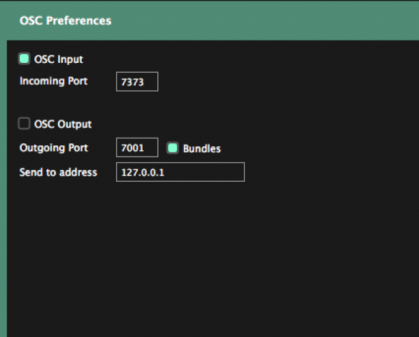

also there is the question if resolume actually gets the osc message, but if the port and host is correct in processing and resolume has it's osc input enabled on the same port that should be working.
In Processing:
Code: Select all
final int portListening = 7001;
final int portSending = 7373;
In Resloume:

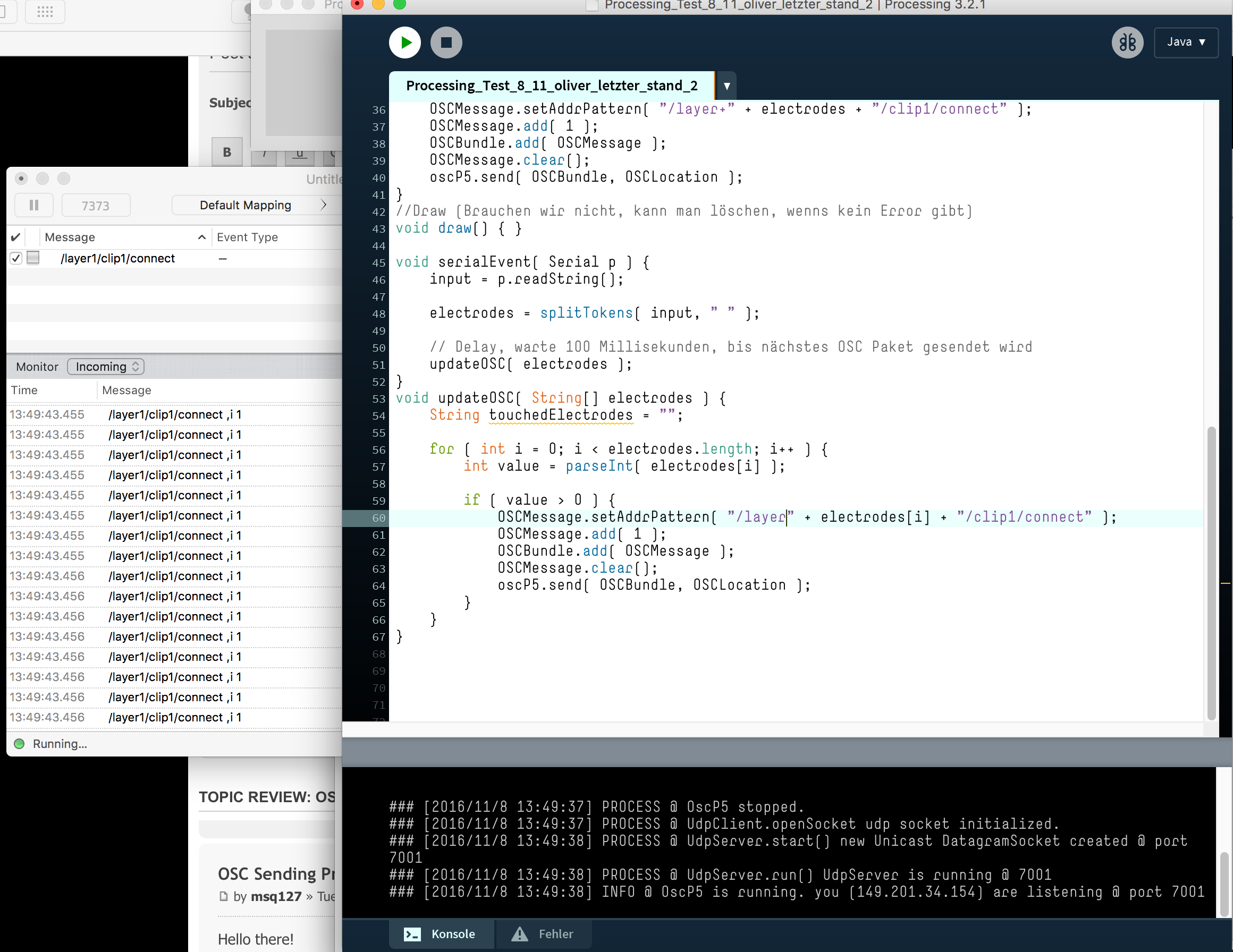

Okay, I got it to work. When I touch one of the electrode it sends out the OSC message and plays the desired video.
Nevertheless there are two problems:
When I have two electrodes connected and sending out osc message they somehow mess up. Sometimes when touching an electrode it plays the video of the other or both.
The second problem is, that sometimes the eletrode needs to be touched twice oder three times, sometimes just once is enough.
This is what the code looks like:

This is what it sends when touching one of the electrodes a single time:
Am I missing something obvious?
Posts: 7605
Re: OSC Sending Problem
you forget to clear the oscBundle after sending it
edit:
also be avare that casting a string to int will result in 0 if the string is
- "0"
- empty
- null
- contains any other characters than numbers
maybe a better, error handling capable way to convert a string to integer would be using the Integer.parseInt(myString) method, which can throw a numberFormatException which you'd need to catch of course.
