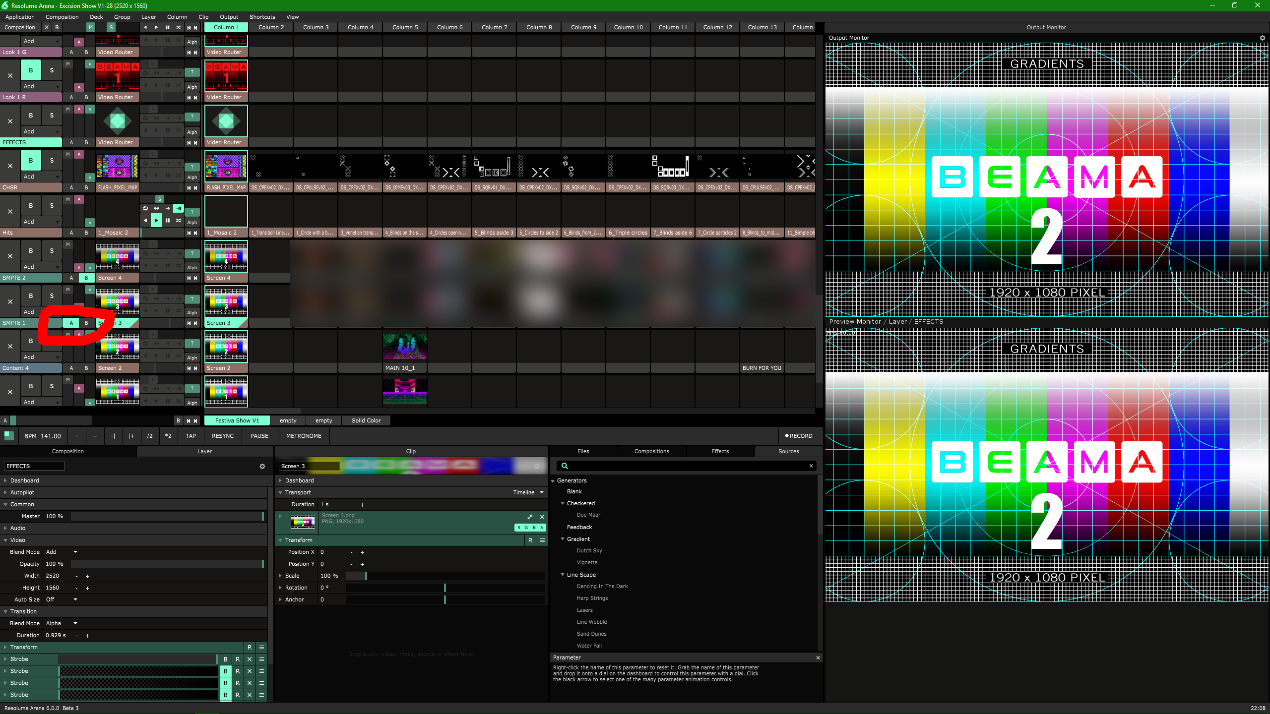

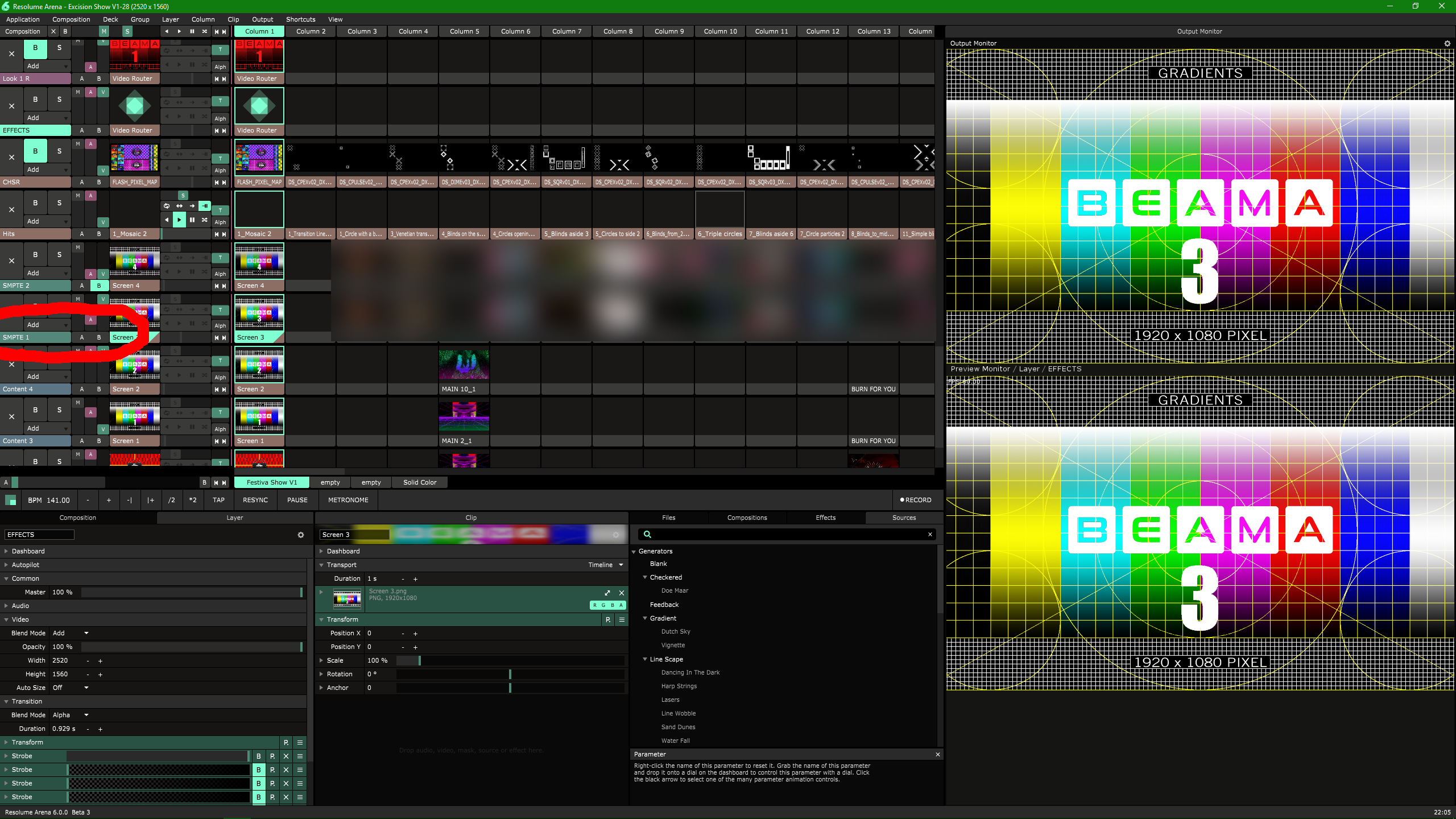

If you try to make two layers ontop of a stack have crossfader A or B they get moved below layers. I have attached photos to explain.
File Order is as it should be
Add A or B and Layer jumps below Stack

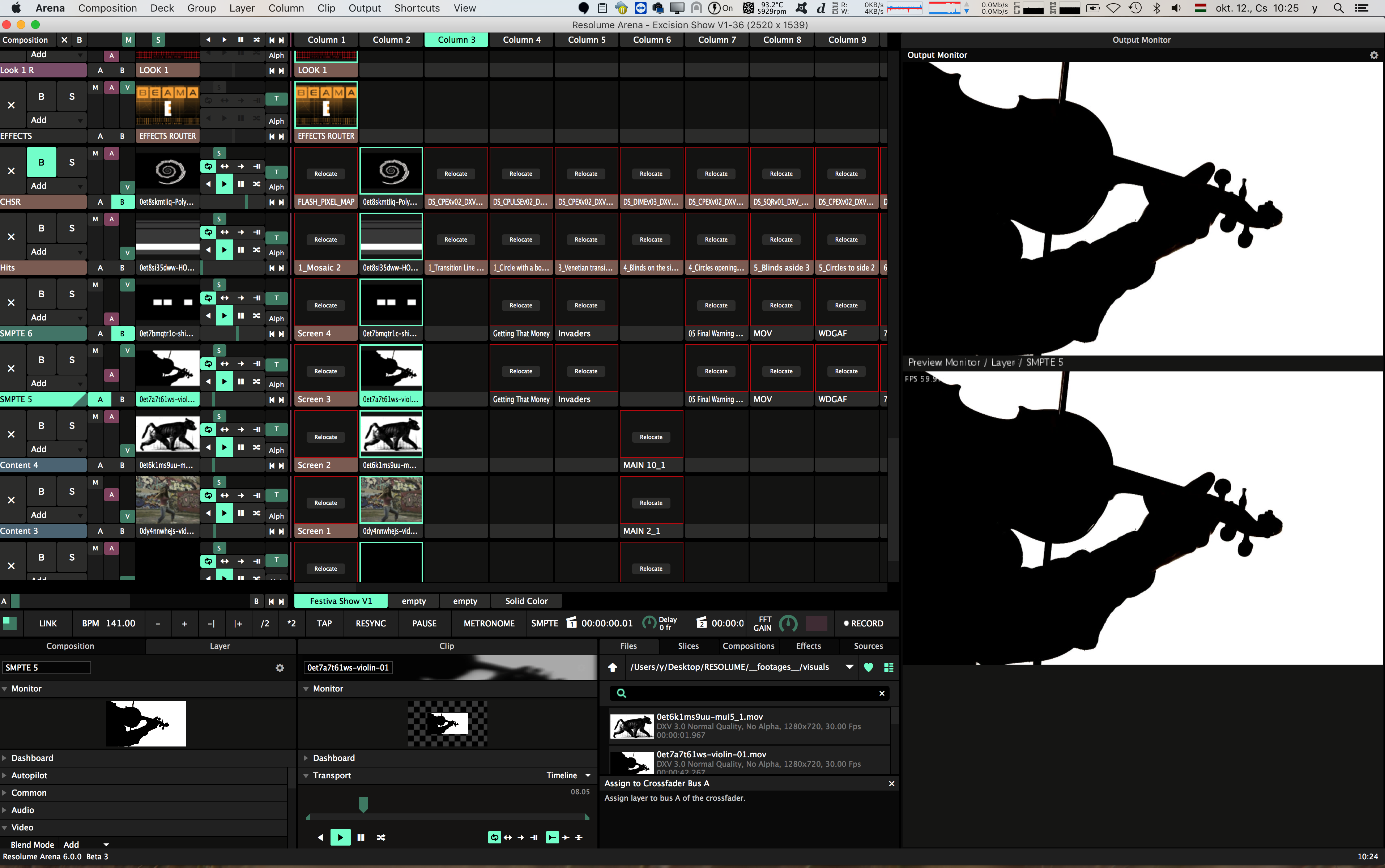

I loaded your composition, put clips into layers 1-7
and I see no difference with the layer 5 crossfader button checked or unchecked.
Layer 5 always plays at the top.
bottom layers also have the AB set, I didn't touch that.
This is strange.

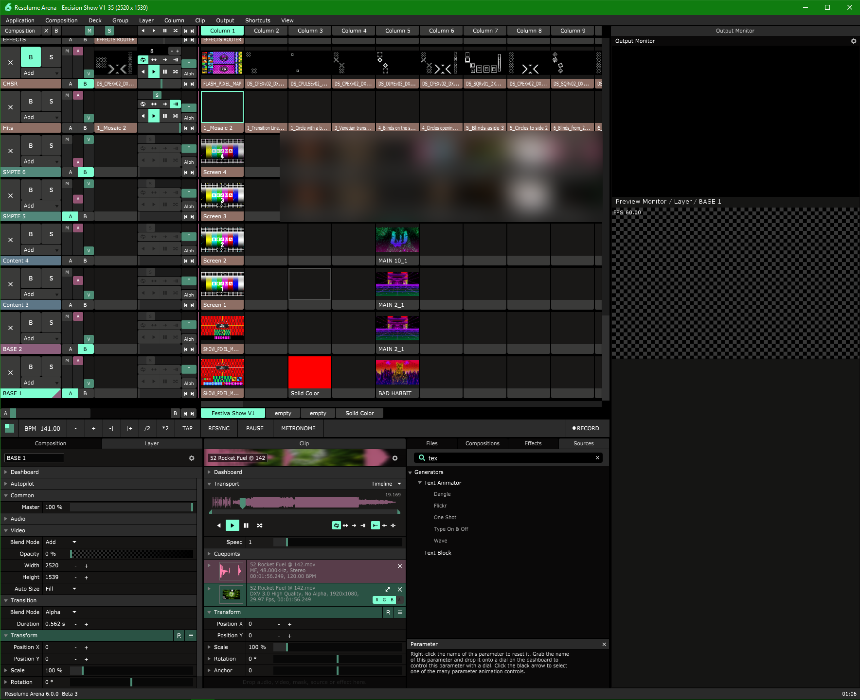

If you have content in BASE 1-2 Content 3-4 and SMPTE 1-2 you'll have Content 3/4 jump above SMPTE 1-2 When Base 1-2 have content and are a/b.
edit edit: you also have to have the opacity up. I can see in your screen that content 3/4 have the opacity down. Set all the opacity layers up and then you can easily trigger it but click and unclicking the bottom layers A/B.
