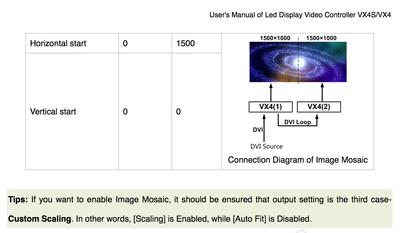

So I had another thought, would you prefer to run two 1080 screens to cover the 3328 width or would you send 1 1080 line, link the 2 processors and then stretch the image to fit the 3328 width?

It depends on your LED processor but you should be able to run the exact resolution you need.So I had another thought, would you prefer to run two 1080 screens to cover the 3328 width or would you send 1 1080 line, link the 2 processors and then stretch the image to fit the 3328 width?

The vx4s we use maxes out at 1920x1080 but it has a mosaic feature where you can link multiple processors for 1 large screen. This feature from what I understand just scales the input and stretches it across your overall screen.Oaktown wrote: Wed Jun 27, 2018 23:21It depends on your LED processor but you should be able to run the exact resolution you need.So I had another thought, would you prefer to run two 1080 screens to cover the 3328 width or would you send 1 1080 line, link the 2 processors and then stretch the image to fit the 3328 width?
Ideally I think I should be using a 4k processor but we currently don't have one in our stock so just making it work with what we have.

No, you can cascade your VX4s to create a larger screen, so you could break down 2 units into 1,664x768 and 3328x768/30 would fit into single link DVI so you should be good!

So if I went with the cascade route I would run 1 output from my GPU and the vx4s would pull the combined res? I didn't think that was possible as the specs say 1920x1080 max input resolution.Oaktown wrote: Thu Jun 28, 2018 01:38 No, you can cascade your VX4s to create a larger screen, so you could break down 2 units into 1,664x768 and 3328x768/30 would fit into single link DVI so you should be good!
