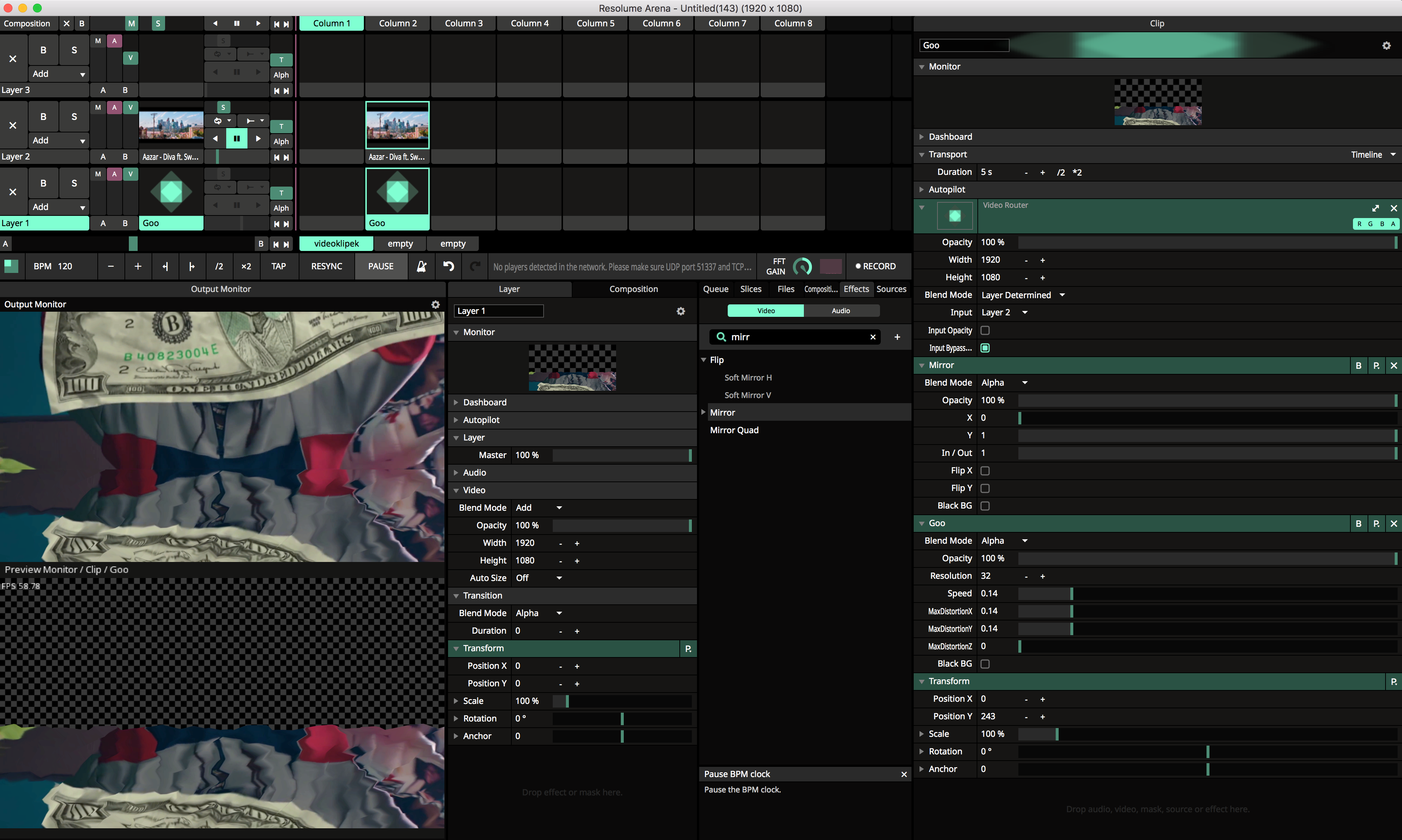

Re: Ocean Surface in FG reflecting light from footage in the BG
How about Mirror and Goo?
