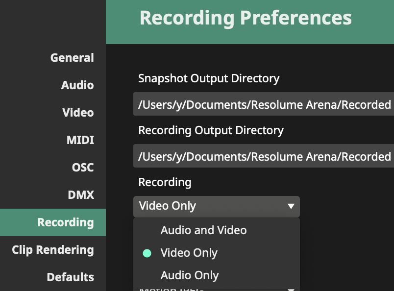

I'm trying to do an audio-reactive clip recording. I can get the video clip to record but when I drag that clip into the timeline there is no audio. I can't figure out why I can't record an audio-reactive clip WITH audio.

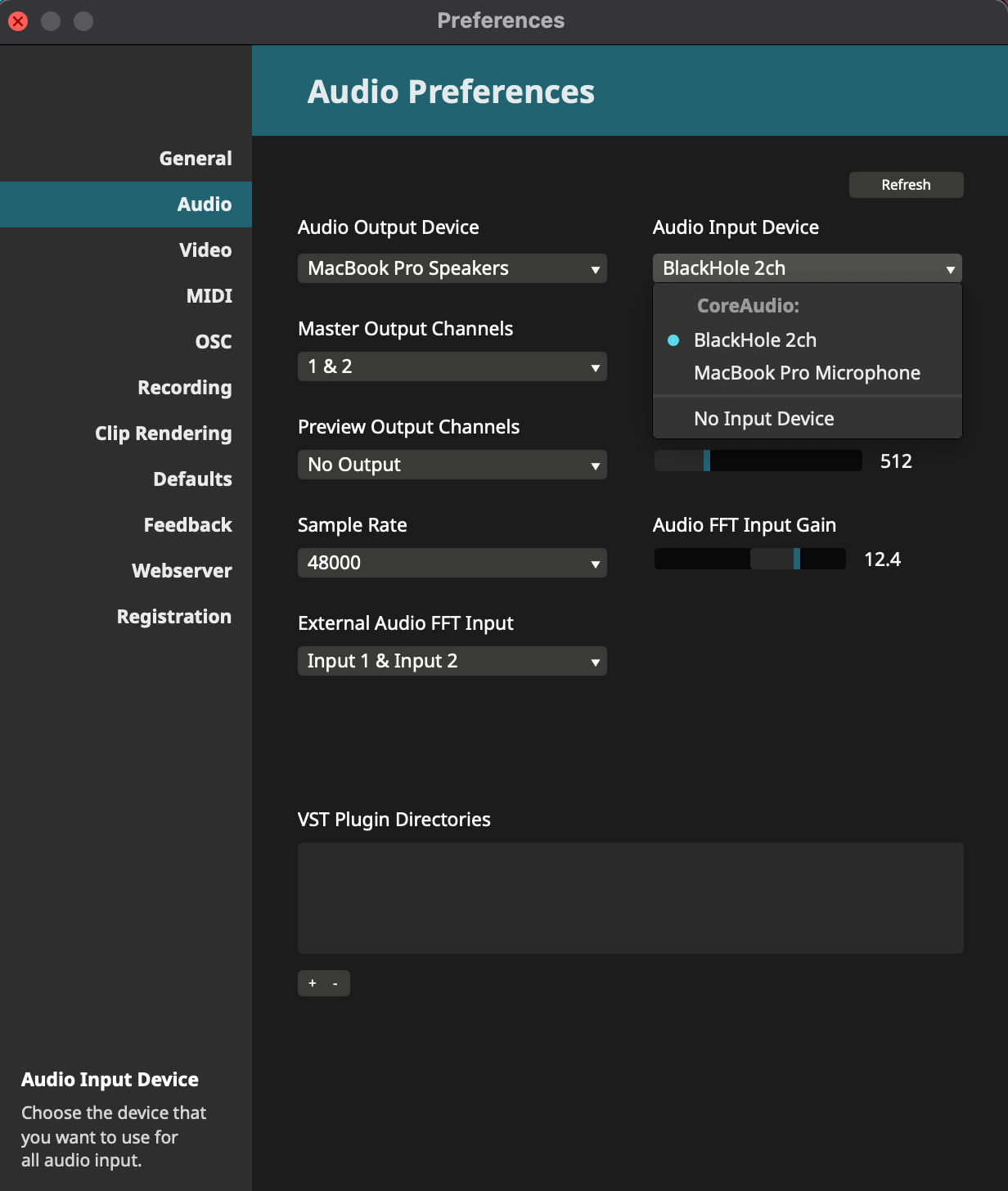

FFT gain shows nothing playing in the EQ.
However, when I simply press record with audio and video playing everything works as it should.
Looked everywhere for a demo of audio-affected clip recording WITH AUDIO, found lots without, none with audio. Could you steer me to a demo, and also please verify my preferences are correct in the included file.
Using M1 MacBook Pro with NO audio interface. Also have a modern iMac USING and audio interface (Scarlett 18i20). On the iMac I tried selecting the Scarlett for input and/or output, Blackhole, Loopback, Soundflower, built-in, and multi-output. I couldn't get any of them to work on either machine.

Playing or recording external audio is not supported currently, sorry.
If you play the audio file in Resolume, that will be recorded if you choose audio + video in the recording settings.

Are you playing the audio in Resolume?
If so, in the recording preferences, make sure to select Audio + Video:
OBS can work great for recording if you play the audio in the same computer, but from a different app.
