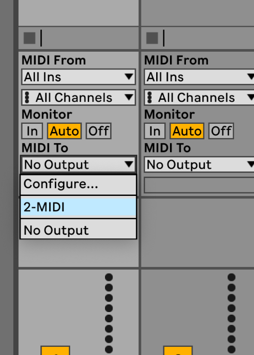

For the Midi, you have to set the midi track in your arrangement in Ableton to send out on the device.

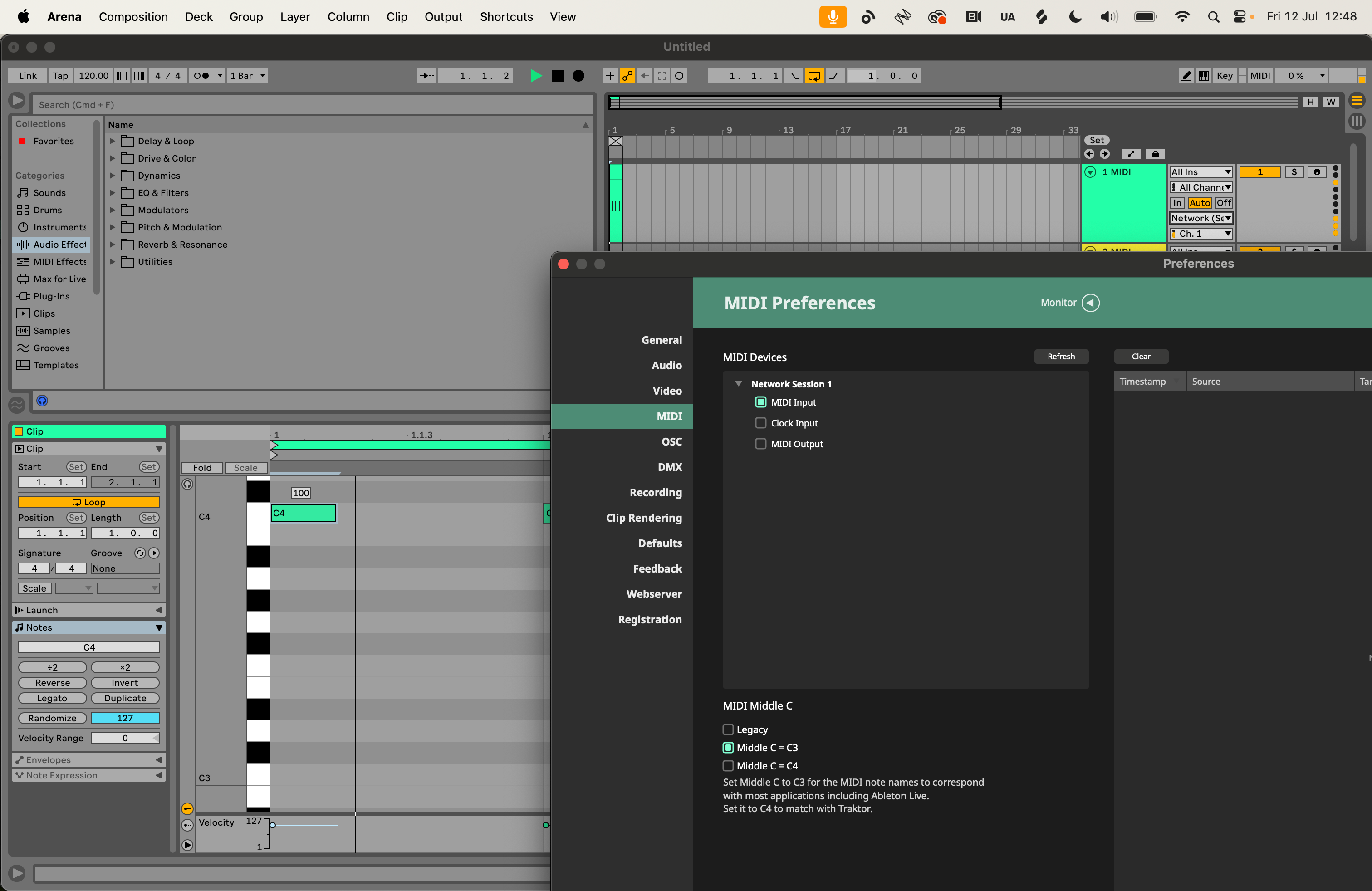

For the MIDI side unfortunately I still haven't managed to get any MIDI input into Arena from Resolume as shown in the screenshot.
The MIDI track is sending MIDI on Channel 1 (or any other channel) of my Network Session and Areana is set to receive inputs from the same network, but nothing comes through.
Any idea of why that might be the case?

Network session is probably not a loopback device.
Try using IAC to create a virtual loopback

Yes my MIDI network wasn't indeed a loopback one, I created one with IAC instead and Arena is now receiving MIDI from Ableton Live ✌️
Turns out the bugs were in my knowledge and not in the software, as to be expected.
