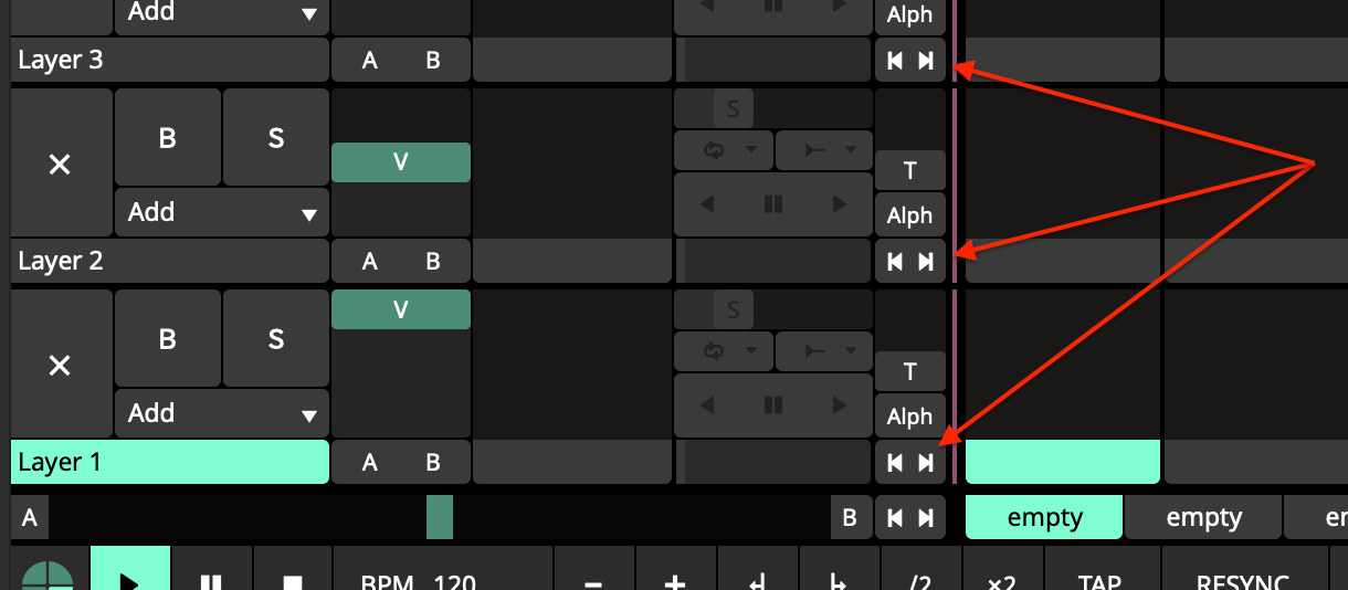

What you're describing isn’t directly possible with a single clip and a single keybinding in Resolume as it is now. But there is a solid workaround!
You can achieve this "step-through" behavior by using multiple clips, each trimmed to play one segment of the full clip (e.g., 0–0.25, 0.25–0.5, etc.).
Just follow these steps:
1 - Duplicate the same clip 4 times into the same layer. For each copy, set the In/Out points so that:
Clip 1 plays from 0%–25%
Clip 2 from 25%–50%
Clip 3 from 50%–75%
Clip 4 from 75%–100%
2 - Set each clip to “Play Once and Clear” or “Play Once and Hold” depending on your preference.
3 - Then assign the “Next Clip in Layer” action to a single key or button
4 - Each time you hit the key, Resolume will launch the next clip in that layer — and when it gets to the end, it loops back to the first.
It’s not fully dynamic like a cue-based timeline stepper, but it does give you that controlled, linear progression across button presses. If you want to get fancier or dynamic with timing and looping logic, you could dive into Wire, but for most live use cases this trick does the job!
