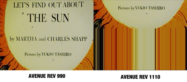

Hey boys. Really nice job on fixing and cleaning the little bugs of version 990. But with version 1110 I have an output problem not seen in 990 making testing not possible.
Dell Inspiron 6400, ATI Radeon 1400, XP

Post by suvanto »
Same problem here.
HP nw8440
XP pro sp. 3
core 2 duo t7200
ATi Mobility FireGL V5200

Is that the output on the 2nd screen?
Probably you dubblechecked everyting yourself but...it looks an effect is applied on the clip, the layer or the composition... check it out.. maybe you overlooked something? That's easy, because the interface doesn't show all the properties all together. Lots of hidden tabs in there ;)
Here the output and the preview look normal...

Post by suvanto »
Yes, preview is ok but second screen looks weird. Everything double checked, no effects whatsoever.
The first beta worked ok for me.

Post by pinchapinzas »
I set the second display using the menu (not the advanced options). Later, I installed the latest OMEGA drivers for my ATI Radeon card and the problem has been fixed. Hmmm. But now arises another problem...the frame rate has droped from apx. 32fps witout OMEGA to apx. 12 fps with the OMEGA drivers. I am wondering...there are lots of options with the OMEGA drivers with I do not really understand. Does anyone have an optimal configuration of the OMEGA drivers for resolume?

I tried both ways to set up secondary screen, same result.
Omega drivers worked really nice with my old computer but I`m not sure how they work with FireGl cards?
I`ll send you the log file, hope that helps.

Post by suvanto »
Installing Omega drivers to Ati FireGL v5200 was not too good idea after all. Resolume didn`t even start after that, insufficient specs it claimed. I`m out of ideas so I guess it`s up to you now gentlemen.

Post by suvanto »
At this point its getting really disturbing. Applying blur effect caused similar problem (blow effect and elevated picture) to preview monitor. After I had changed effect parameters randomly for a while, picture in preview monitor was almost normal. Then I changed to fullscreen and WHAT! The picture was almost normal there too. As you can guess I couldn`t reproduce this after restart but maybe it helps you to spot the actual problem.
