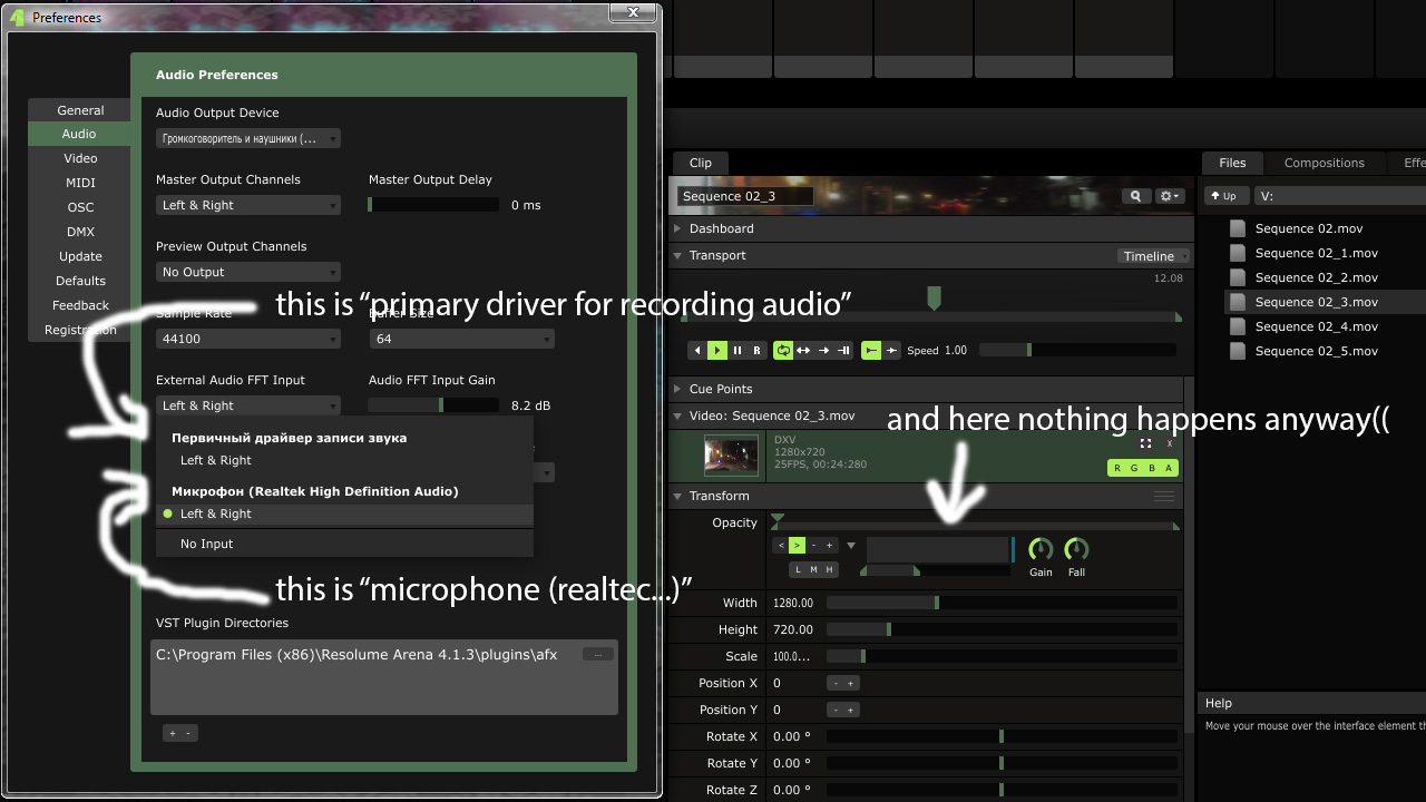

i have the opposite problem.
my built-in mic doesn't work.
(i mean the one which is hidden somewhere in a laptop keyboard, not the 3.5 input)
it works perfectly in skype.
i have reinstalled my audio drivers and resolume arena as well,
and i definitely remember it worked on my previous laptop with resolume 2.4))
what can be the problem?

I have the same problem as kudr86. When I try to do an audio analysis fft in resolume 4 avenue or arena nothing happens. But when I try to do the same in resolume 2.41 everything works perfectly. Anyone has an explanation about this problem? Am I doing something wrong? Please Help. :roll:
