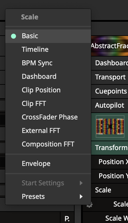

You have seen how a wide variety of things can be controlled in Resolume by moving parameter sliders, from the volume of the composition to an individual setting on an effect. You can create dynamic looks just by moving a few sliders.
The good news is you don't need to give yourself a repetitive strain injury to achieve this. Instead, you can set parameters to animate by themselves.
To access these options, click the grey cogwheel next to the parameter name. A menu will appear.
The options in the menu will be slightly different depending on whether the parameter you are working with is for a clip, a layer, a group or the composition. However, they all work in much the same way.

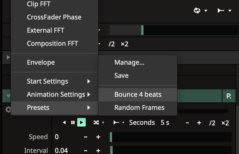

Parameter Presets
Parameter animations can be saved by creating presets. This prevents you from having to create your favourite animations over and over again.
At the bottom of the cogwheel menu you will find a preset section where you can save, manage or apply presets to your parameter.
A parameter preset will save the playback mode, loopback mode, timeline mode, duration and envelope, start settings and animation settings . In/Out points are not saved.
