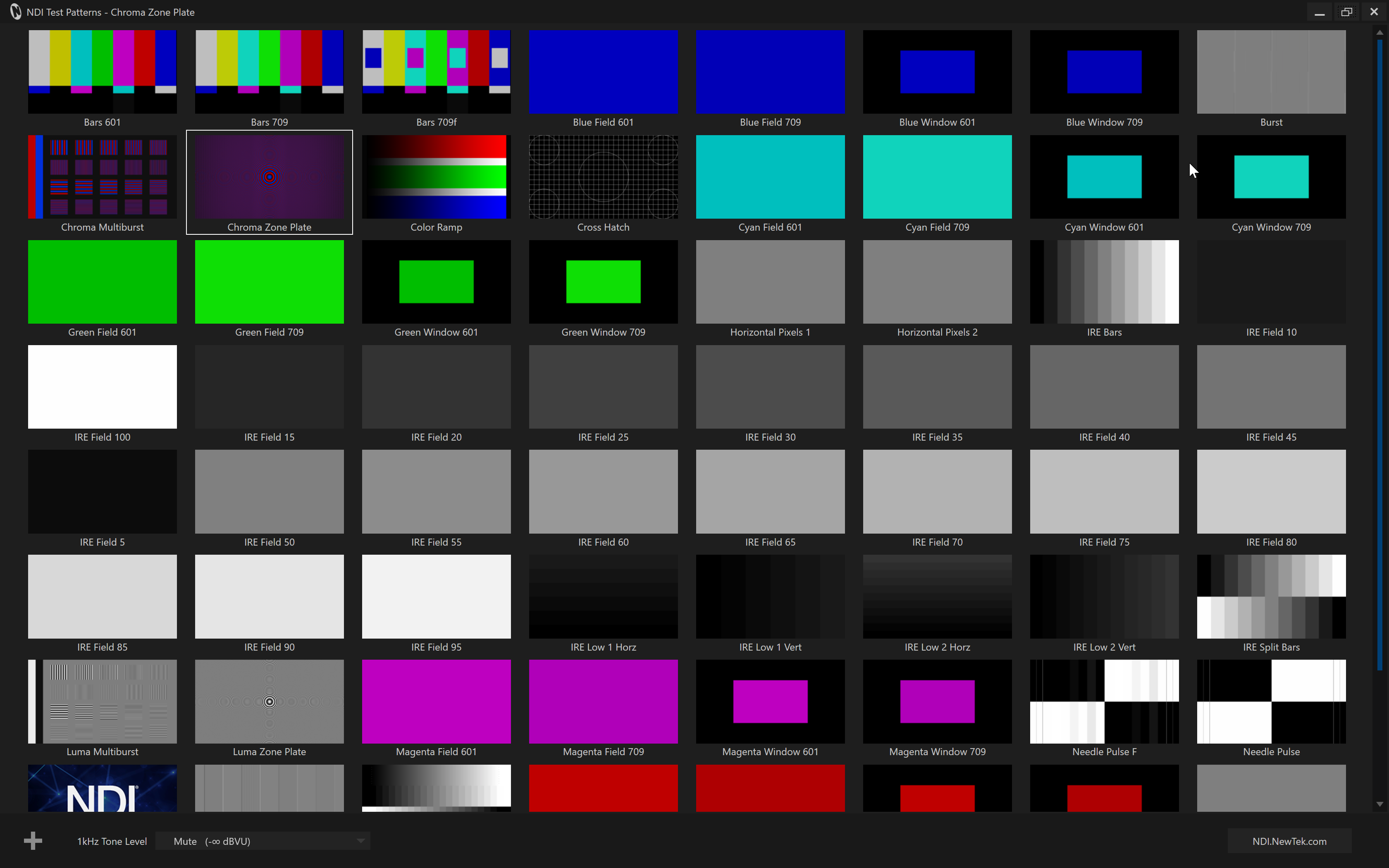

If your question was: Is it possible to change the default test card for Resolume?
Then the answer is: No
If you are on a PC, you could use NDI Test Pattern app which is part of the free NewTek NDI tool kit which gives access to a lot of various test patterns AND gives you the ability to add your own:
