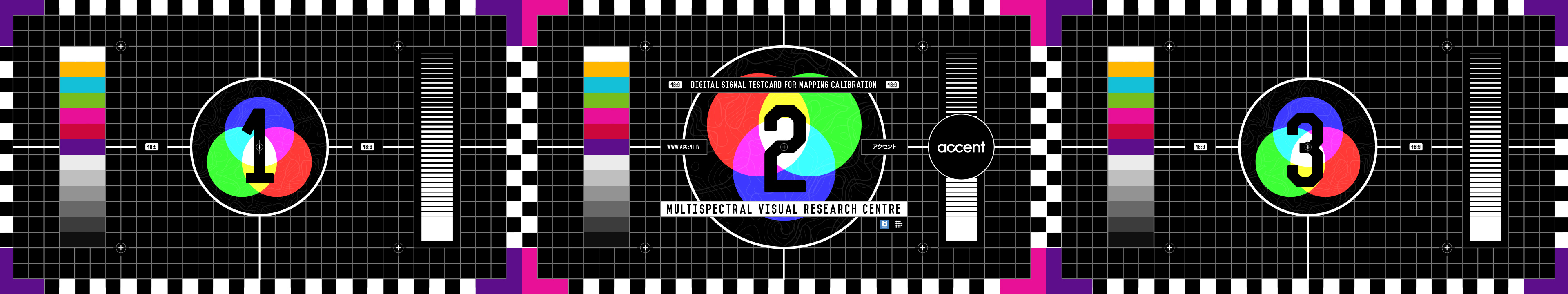

Hello in resolume arena 6 it is possible to edit the test card and add a one made by yourself visually speaking as those of accent tv.
If not, what program would you use to achieve this?
I have seen several that have done it but I have not been able to find it like.
Thanks in advance

Dropping the test card to the composition and playing it like a clip should work.

If your question was: Is it possible to change the default test card for Resolume?
Then the answer is: No
If you are on a PC, you could use NDI Test Pattern app which is part of the free NewTek NDI tool kit which gives access to a lot of various test patterns AND gives you the ability to add your own:

I have an entire DECK full of different test cards. 40+ clips.
If you're doing a lot of advanced slice mapping, I would highly recommend building a deck for this tool/purpose.

and here's a nice free testcard generator for mac while we are on the topic: http://www.sigmasix.ch/testcard/
